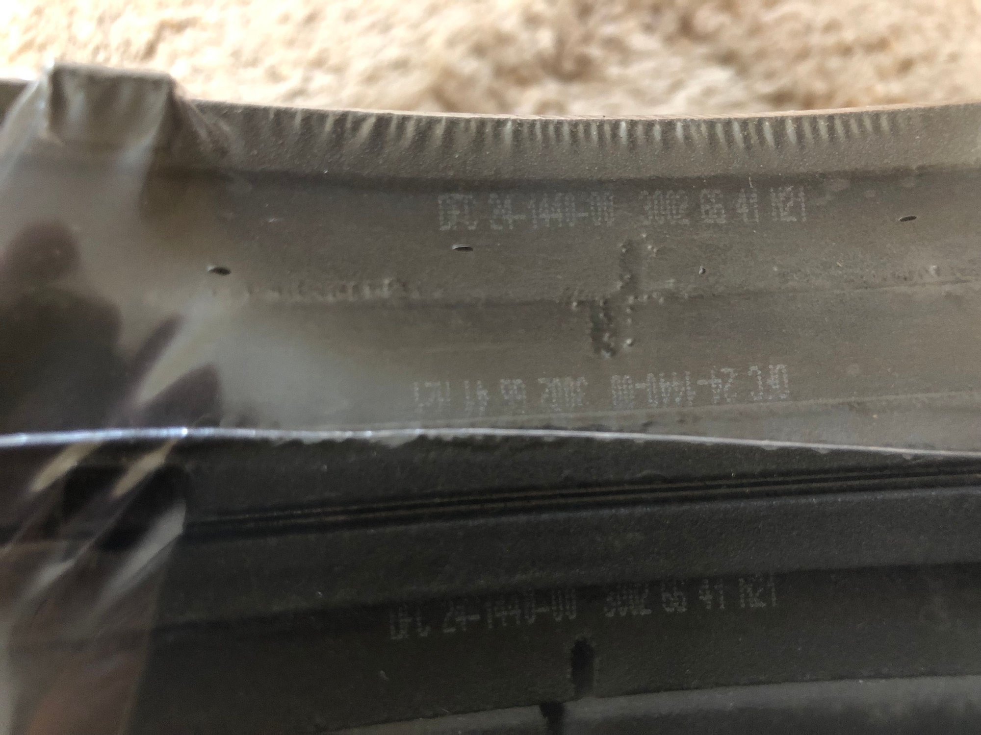

Default DFC Active Performance Brake Pad Review
I’ve seen at least one RCF owner, one GSF owner, and another ISF owner use these pads.
I mostly do street driving and commuting on the RCF so I never felt the need to get track ready pads that costs hundreds of dollars. First time I changed the pads I used Brembo pads P83154N. A few people used them on the forum and was recommended so I tried them.
The Brembo pads came in less than $100 for the front pair and I found once they were broken in I got a good bite. The problem was that under frequent hard braking they would give up. Even a 20min canyon run was a no no. As an everyday pad they were great and other than the fact it was not capable of repeated stops they also dusted a lot.
So after reading a few F owners actually using the DFC performance pads on light track work and read their operating temps went as high as 1400 deg, I wanted to give them a shot. One member sold me when they said they used them on their ISF and reminded them of Stoptech 309s (which I had on my previous ISF …loved the bite and ability to produce multiple hard stops).
I decided to see how they would do on my wife’s car (Acura ILX) which was due for a rear pad change. Had it for a few weeks and they do bite hard and definitely stand up to repeated hard stops. I also noticed they don’t dust like performance pads that I am used to and are quieter than I thought (actually not a squeal).
So now I’m up to change the brake fluid, front rotors, and pads for the RCF and see how well they hold up. I’m getting them installed this Saturday…then do a few bed in runs. On Sunday I’ll go for a little canyon run and let you all know what I think. If these are as good as the Stop Tech 309s I’ve had then it looks like we have a streetable semi-track / autox pad that can be had for $100.

Friction rating GG

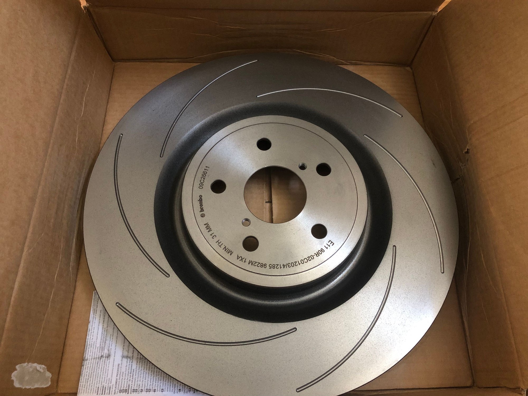

Brembo rotors for $150 at Rock Auto!
