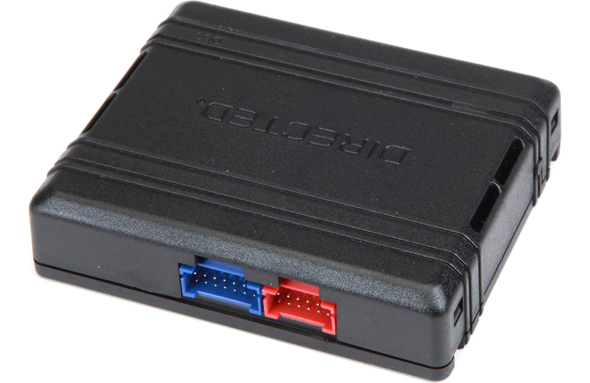

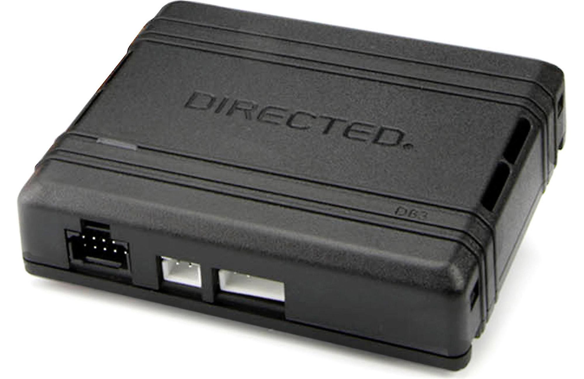

I have the 12v remote starter for my rcf, wife's nx, and for my ct200h. Technically the ct I made it myself but it uses the same module that pretty much ALL remote start kits use. Directed Db3 module. These normally go for $80, you can buy a T-Harness for around $20. Tape 3 wires into the t-harness from the directed module and you now have a plug and play remote start module.
It takes 30 seconds to program and you don't have to do anything with any stock wiring or remove anything. Uses OEM fobs and 3 clicks of the lock button and the car starts. You can pay the $300 for the prebuilt kids like 12v solution or do what I said above and make your own for $100. The directed module tells you exactly which wires to tap. On the CT, it was the parking lights, and two other wires right on the bmc harness. Super easy.

I only see mention of the DI DB3 module as a door lock module, is it pushing a signal to the starter as part of the "override" its capable of? It also seems to be a generic module so how did you find the leads to tap on our cars to turn it into a 3 click lock remote start?

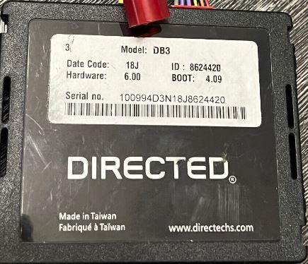

To be honest I don't know but this is it:
Directed DB3 Databus All Interface Module Connects a security/remote start system to your vehicle's databus at Crutchfield
This was my kit for my CT.
Three wires to tap on the BCM connector.
In the manual for the module, I had to tap 3 wires on my CT200h. Parking lights and then two other wires BTX/BRX. I'm fairly certain these are going to be almost pretty standard on ANY Lexus that's new... When I looked at my RCF remote start, it's three wires, my wife's NX, it's three wires. My ct200h, 3 wires. It's all the same thing. They use a T-harness and then everything is plug and play. Then you hold the button on the db3 until it's red, turn the car one twice and it's programmed to do remote start. Super easy to do. Literally a 30 second program/sync.
