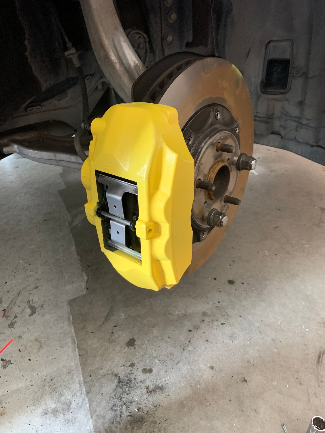

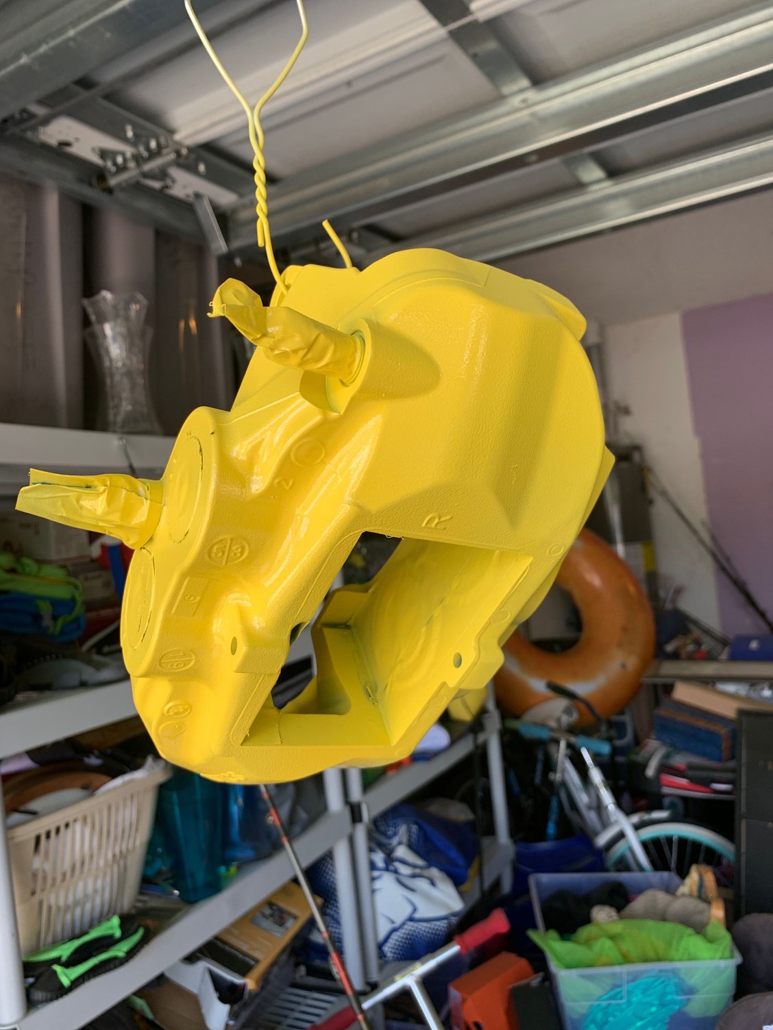

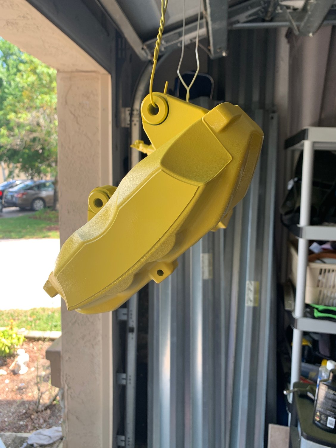

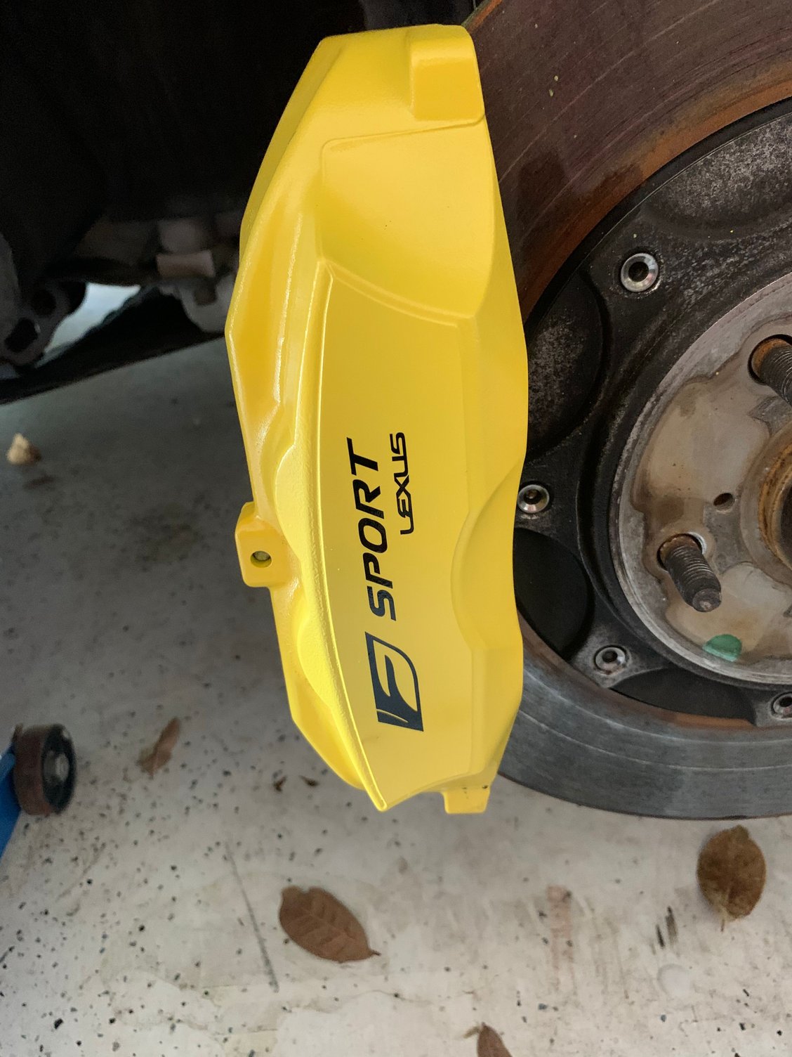

Started a little project this weekend. Wheels are being purchased in the next month or so. Front brakes were making crazy noise so it was time to replace. Picked up a set ok akibono pads and decided to paint the calipers.
I washed and degreased them with a wire brush and brilliant, than took some sand paper. 3 coats of primer and 3 of yellow
very happy with the results so far. I just ordered some basic Lexus sticker off eBay to throw in down the road
rear brakes next weekend plus spark plugs

Mounted

That looks awesome. I never realised how straightforward it would be to paint them instead of ordering painted ones. Did you say you were going to put a Lexus sticker on them all?

Yes I ordered a Lexus sticker on eBay. Should be here in a day or so. I’ll put some nail polish remover over the sticker when it comes. Taking the caliper off is a breeze a weekend project forsure

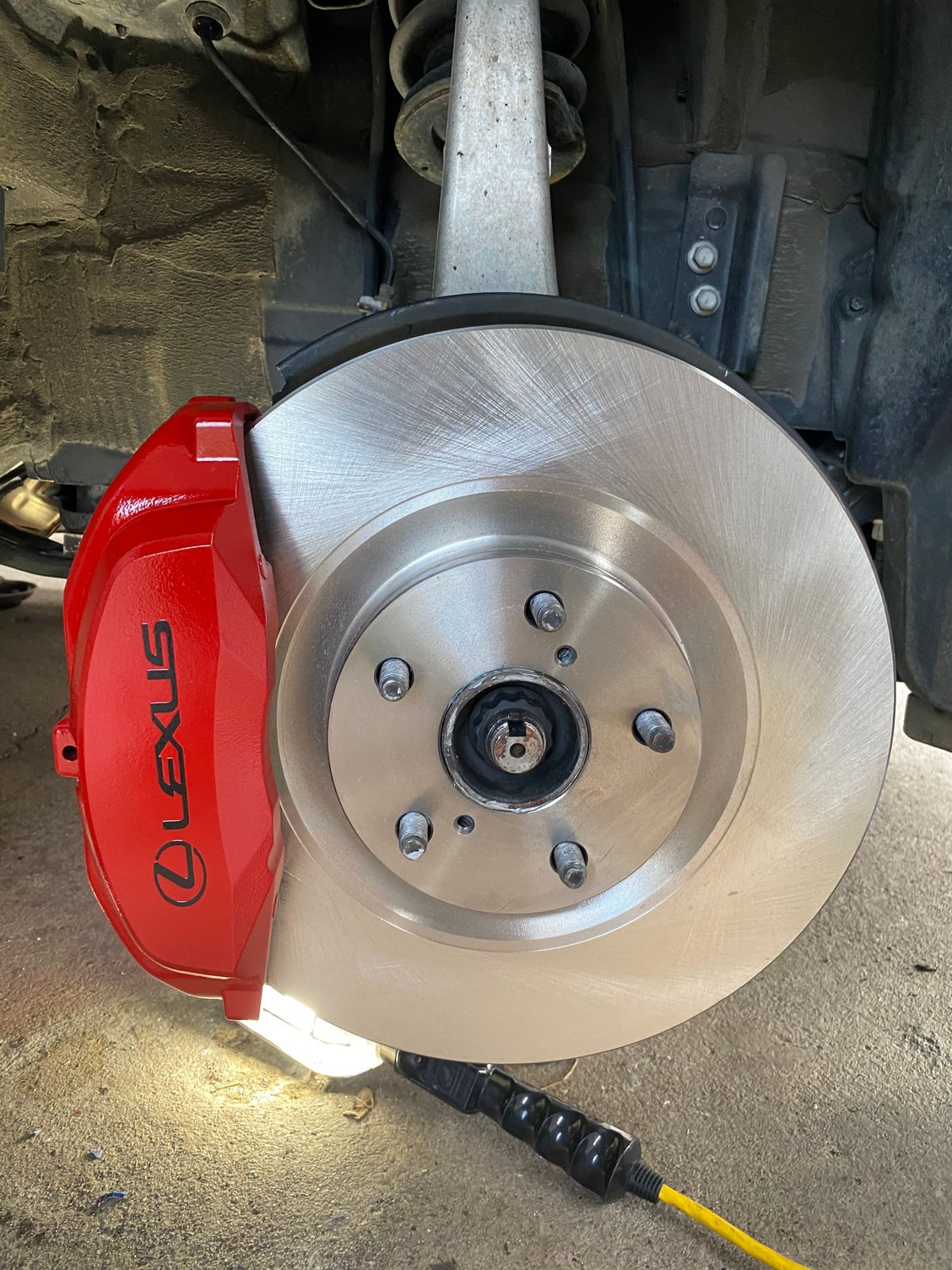

All done rotors freshly cut new pads andnpaint

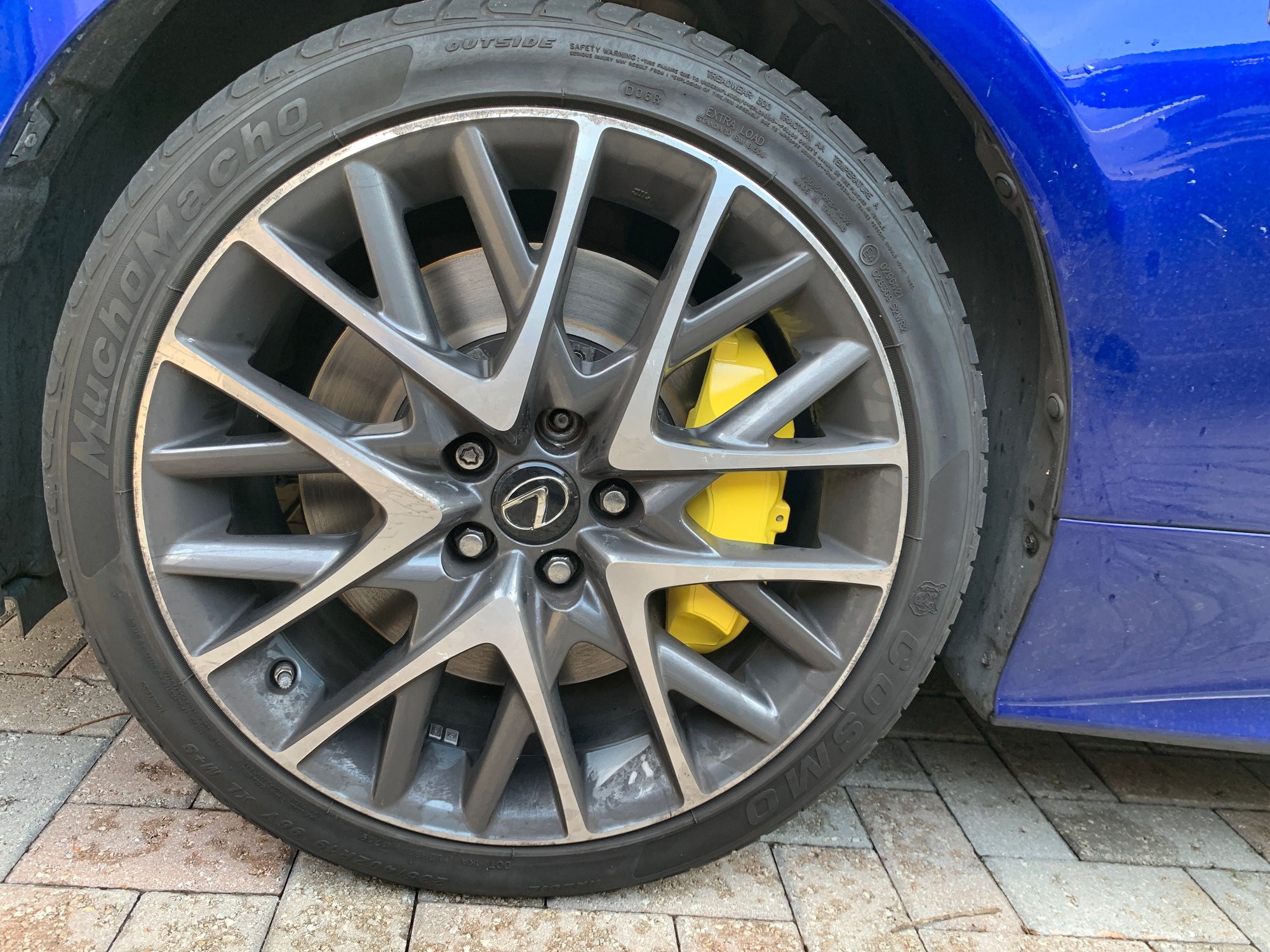

All
all done now

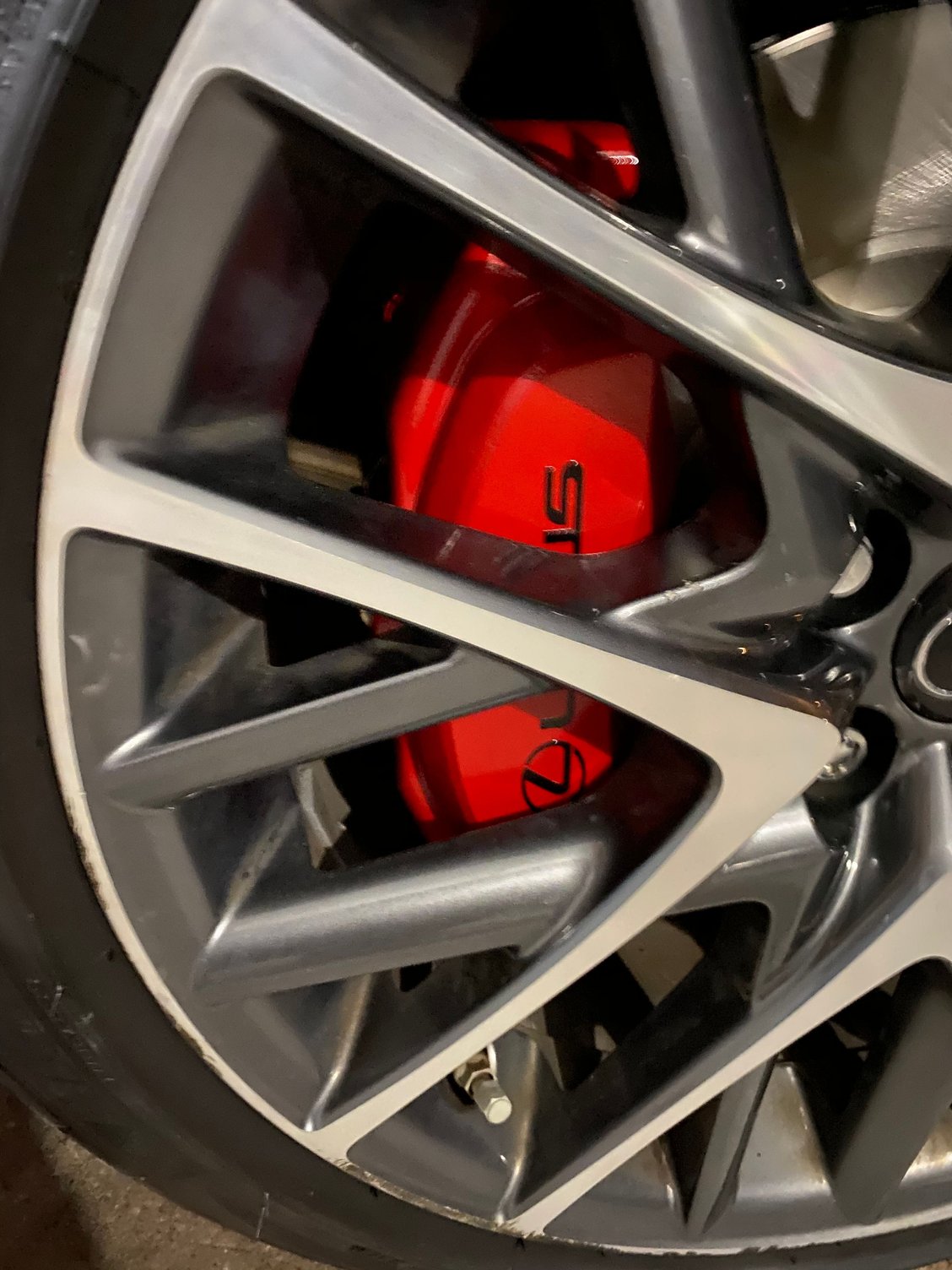

Thanks for the inspiration fellas. I just painted my calipers while doing my front & rear pads/rotors. Also bought some lexus decals off eBay to put on. I did 3 coats of clear-coat on top of the decals and it gave a nice shine & finish to the calipers. I didn’t think it would be too visible behind the OEM rims with all the spokes, but the colour definitely shines through and looks very nice.
