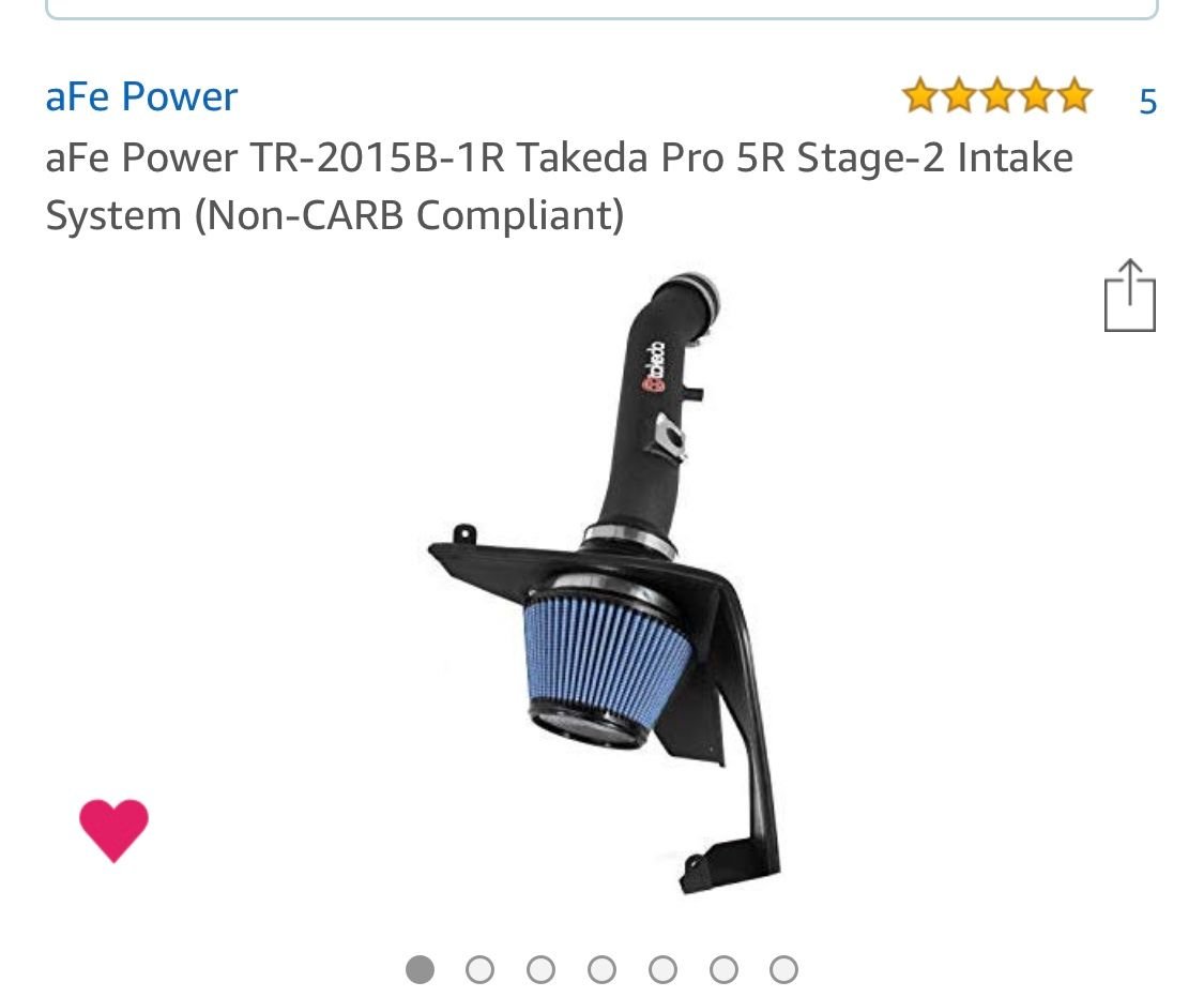

Hey all, this is my first post here
Im getting this stage 2 CAI for my 350 F Sport, but wanted to know if it would require a tune or not.
My car is stock, with a simple muffler delete. I wanted to be sure that a "stage 2" intake didn't require a tune to void warranty at all, and I am not sure what stage 2 means.
Any help would be appreciated 🙏🏽

Does not need a tune.
Just straight install, and won't have any issues.

Just a heads up, I used hose clamps to hold the hose onto the intake because the oem clips were not strong enough. It's a quick and easy install.

Harbor freight sells them in a pack for a great price. No tune needed, just don't over tighten the MAF or you'll strip it.

I installed one of these 6 months ago and have had no issues with CEL and have not yet bought a tune. You will be fine.

Its a fun, quick, and easy install. Pick up a 1 or two inch hoseclamp for the crank case vent hose.

Only added one clamp. I placed it just on the crank tube with the screw pointing up so I could access it easier. Then slide it around the bung on the intake and tighten it down. Super easy, I can take some pics later tonight if youd like.

The kit ended up coming with a few clamps for both the filter area and the crank tube, so I just buckled it all down!
I appreciate your help and advice, just installed it last night and so far no issues at all, but plenty of sound and a more sensitive throttle!
