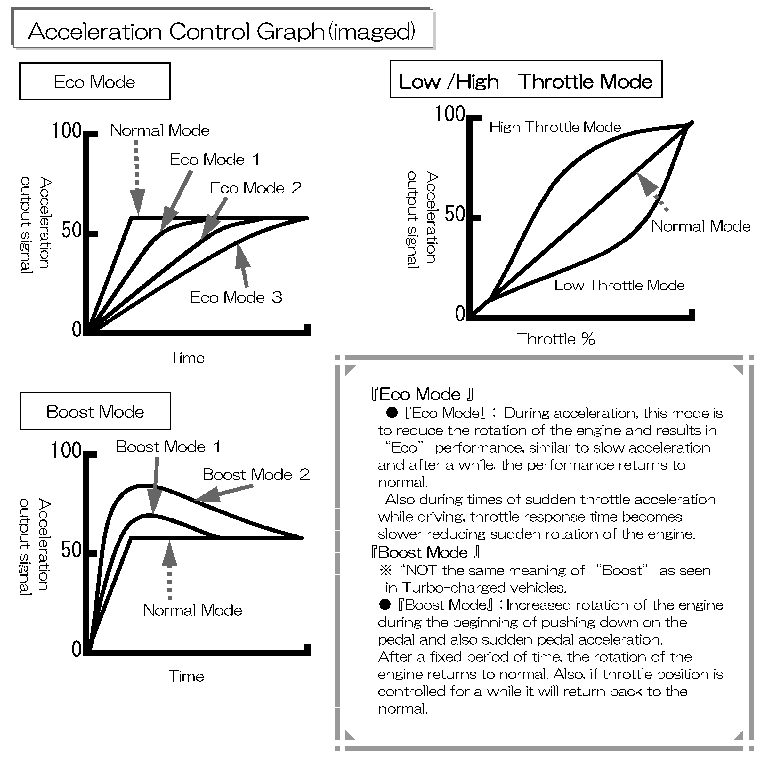

Here is the graph of the modes the Apexi provides. This may help your decision for it. @matthewsil

So this is just plugged in line like the pedal commander? No issues with warranty via Lexus?
would love to do more but want to take advantage of my warranty. Priced the rcf exhaust and as expected way over priced. Looking for a free flowing setup. With deeper tone.... just not the average “fart can”. In ca so I need to run cats.
And is is this basically the same function and setup as the pedal commander? Any pros and cons of one over the other?

No warranty issues. Its just a bypass from the stock pedal response system.
