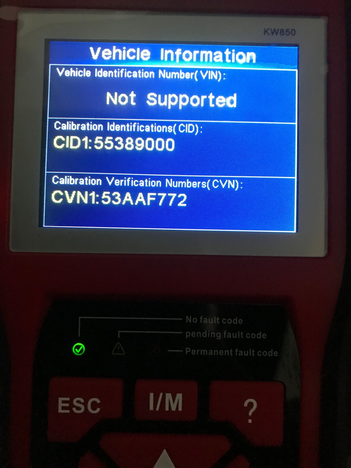

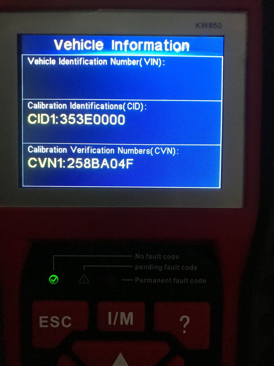

Thanks - great idea. I did noticed our CAL ID are different, your car is a IS350 correct, what year model?
I have passed the photos onto RR Racing, awaiting a reply now.

RR Racing confirmed they have a tune file for my CAL ID

FWIW, calibration ID's vary for any number of reasons and Australia/Japan/other countries ID's will not match North American cal ID's.
