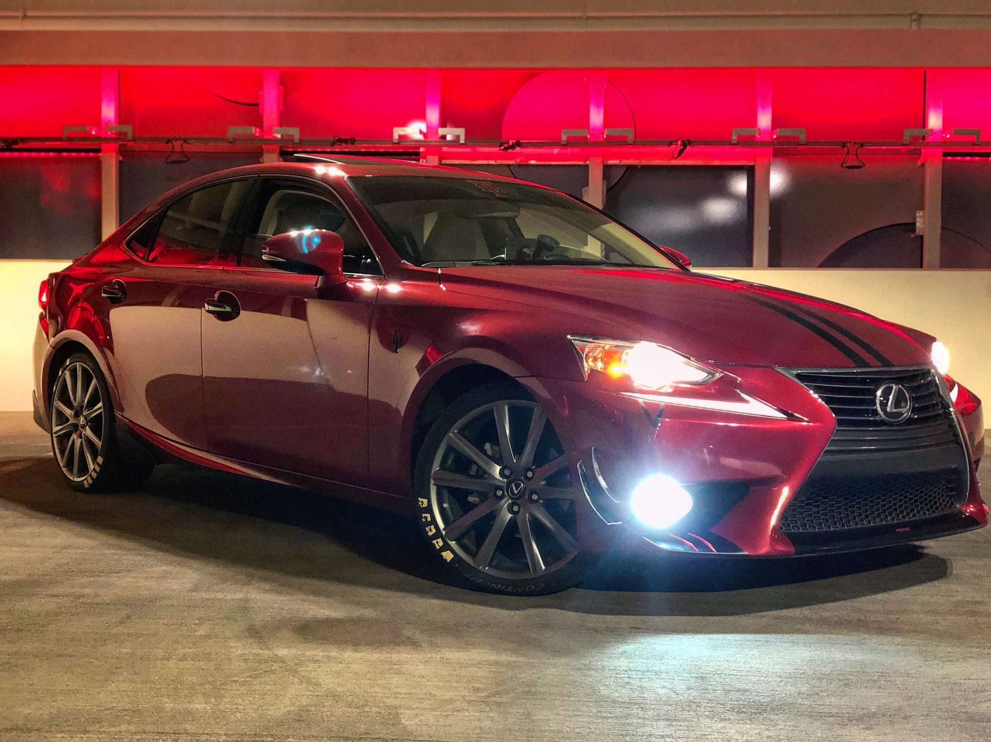

Do you have a larger pic of your avatar pic? I wouldn't mind seeing it.

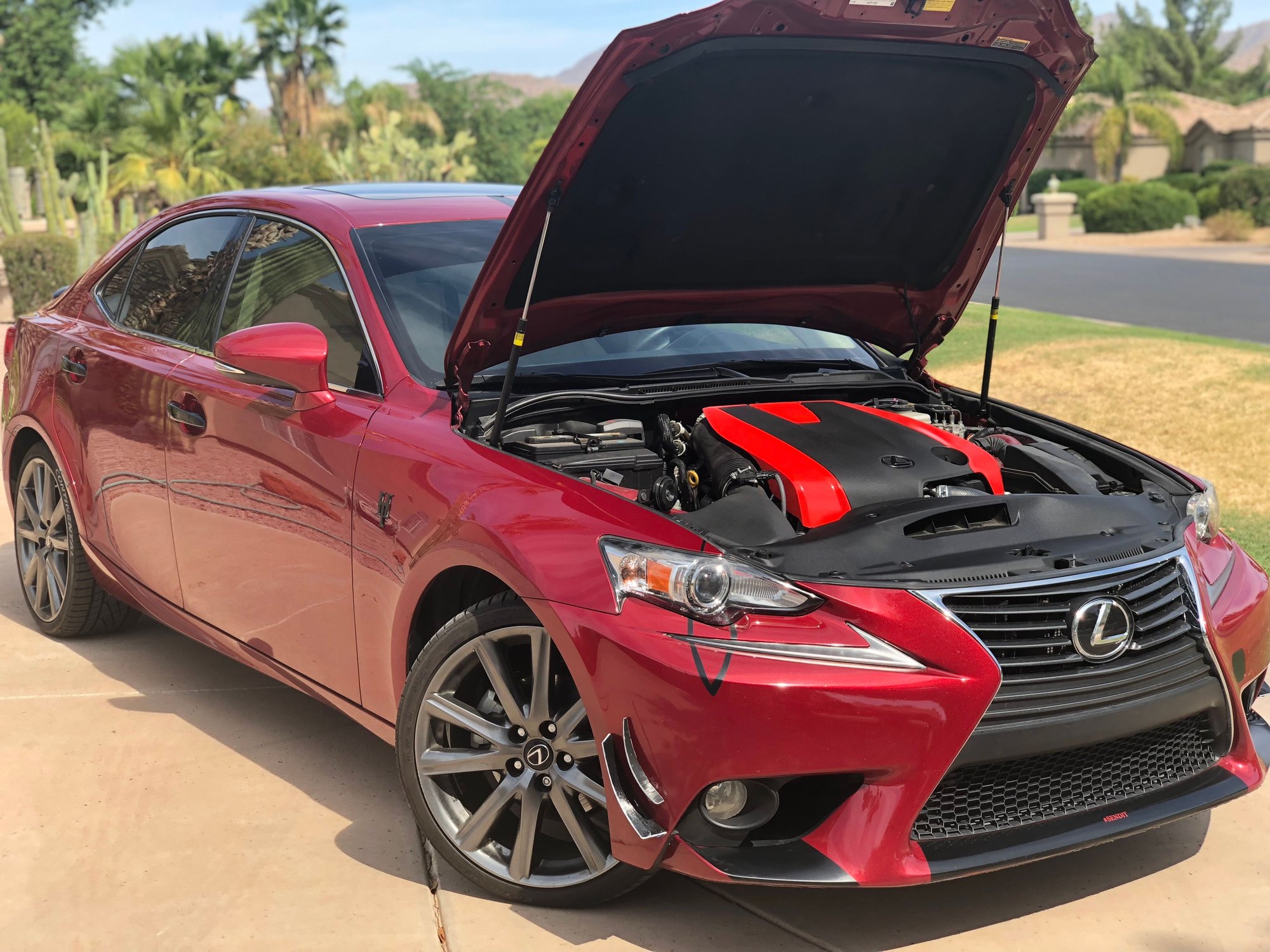

Mods
Avatar pic
Old Mar 26, 2019 | 08:20 PM
spraytask's Avatar
spraytask
Joined: Jul 2017
Posts: 56
From: California (CA)
Looks unique! Have you considered blacking out the chrome trim on the grill? Just an idea, good luck with your build!
I already did that! . Looks pretty good
