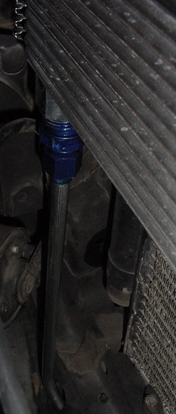

Default Line1
Line 1 polished 3/8 " #6, stainless steel lines
Note the connectors.

Default Steel line
I will be connecting both steel lines together with a braided steel line. Till then, only 5 inches of rubber hose is perfect.
