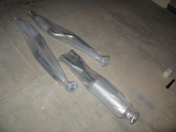

sorry i forgot to mention that i am fitting the Megan Racing exhaust mid pipes bellow:
