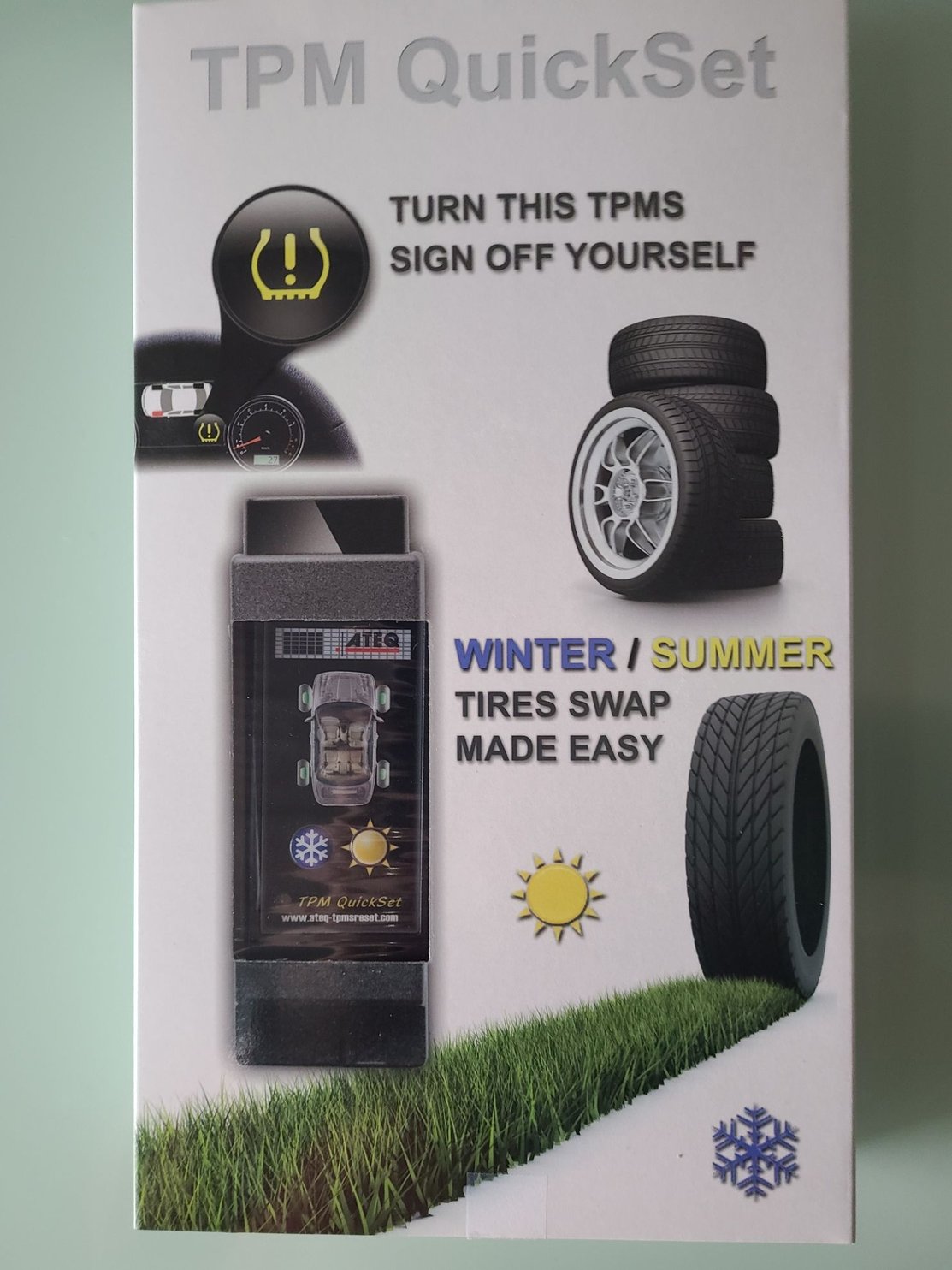

I think the new process is easier. I had a Gen 4 RX and the car would only store 1 set of TPMS codes. These new ones store 2. All you need do is A- get proper sensors that the car can read and B have the dealership program them 1X and you are good to go. It's described somewhere in the owners manual. That's what I'm doing, the winters are at the dealership now, all I need is the car!
For Gen 2 RX there was a button under the glove box which allowed you to switch. On Gen 3 and 4 RX and I guess Gen 1 NX you had to reprogram trough the ODB port. I had purchased an Ateq TPMS tool that did the job. It's for sale now as I won't need it for this generation of NX/RX.
