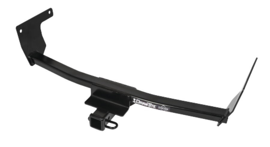

Just as a heads up, I just ordered the Draw Tite 76634 hitch:
https://www.draw-tite.com/Product/76...-trailer-hitch
on the etrailer website it is called DT82QR:
https://www.etrailer.com/Trailer-Hit...te/DT82QR.html
to put on my 2024 NX350h. I will post again (with photos) if it goes on well. Both Draw Tite and Etrailer confirm it for the 2023 350h, so I'm assuming it works for the 2024, though I may be the first one to try.

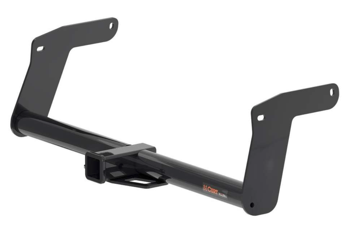

In the past I've used a lot of Curt hitches, but from the photos I've seen the crossbar on the Draw Tite is much more hidden than the Curt model https://www.curtmfg.com/part/13498
In fact, just looking at the photos from the web you can see that the Draw Tite crossbar is forward of the rear-most mounting holes, while on the Curt the crossbar is much further to the rear of the rear-most mounting holes.
Draw Tite 76634
Curt 13498
I will also let you know if the kick sensor still works well. I'm hoping that the Draw Tite being more "under" the car will keep it out of the way of the kick sensor.

OK, I got my Draw Tite 76634 yesterday from etrailer.com. As others have pointed out, any hitch ordered from etrailer will come in a mostly-destroyed box! They apparently are very against proper packaging.
I cannot install it all by myself. I live alone, and it's just too unwieldy to maneuver up into place without someone lifting the other end. I'm 99% sure it's going to fit on the 2024 NX350h, but I have an appointment at a garage tomorrow to have them put it on for me. I'll update later.
