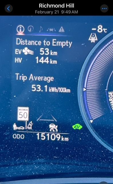

After full charge, mine shows as in the picture, EV range of 94km. Btw thats the highest i have seen

The EV range of 94km depends on my daily driving habit, if I am on 401 and i accelerate/speed then it will use the EV range quickly, so yes, it is the software calculation. When I got the SUV I was getting EV range of 74km but after few months its always between 88km - 94km.

Due to cold weather, full charge to my NX450+ shows as 53km - 56km, I am using seat warmers and steering wheel.
Should improve in summer weather.

In the EV world (e.g., our Mach-e and i4 40eDrive) this range variable is known as the "guess o meter" or GOM. And it's subject to all of the variable mentioned above (e.g., speed, temp, wind, rain) as they all affect efficiency.
