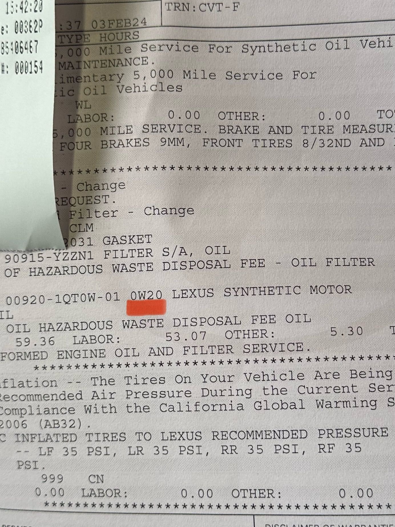

Hi Guys.
Today I had my first service of 5000 miles. So I added the oil change (0W16) service where the price was comparable at this dealer compared to local mechanics and Toyota dealer as well. So after the service was done, I saw 0W20 clearly indicated on the invoice and I stopped right there without signing anything. (see below picture)
I told the cashier that you guys used the wrong oil and I’m not paying for it. The guy said please talk to the service advisor. I went to my service advisor and told him the situation. He said “ that’s what your car requires”. I said “ Uh, NO! My car requires 0W16 and took him to the car and opened my engine hood to show him TA-DA”. The guy immediately flipped and said “ Oh, let me be back real quick I’ll explain it to you”. I was like OKAY. After 5-10 mins of running back and forth, he comes to me with a recommendation from Lexus saying it’s okay to substitute 0W20 for 0W16 more than one service interval due to shortage of parts which overrides the manual recommendation as shown below.
So I was like I know owners manual says it’s okay to substitute 0W20 temporarily but I told him that I don’t believe there is shortage of 0W16 anymore. The dealer clearly used 0W20 because that’s what they have on the lot. So I had the service director come to me and we went over like 15 mins of it’s ok vs it’s not ok for me etc. The verdict is guys I have taken in writing from the service director that nothing will happen to the car since they have used a different oil but I wasn’t happy with that and I demanded they change the oil to 0W16.
Question is am I taking it too seriously by demanding them flush the oil they have used and use the right oil OR should I just stay chill and use 0W20? Thanks in advance for your input.

The manager’s written statement was unnecessary since your receipt shows what oil the dealer put in it. 0W/20 is fine. That’s what I put in daughter’s 2018 RAV4 which also has 0W/16 written on the oil cap. The primary drive towards thinner viscosity oil is to increase fuel economy, not engine performance. While it does better on cold weather starting, that is not the primary reason. That being said, the dealer should have notified you 0/16 was unavailable before putting it in. Note, 0W/8 is now being used in certain Toyota vehicles, like my other daughter’s 2024 Corolla. That oil is hard to find on the shelfs. 0/16 can be used in it’s place according to Toyota.

You will be just fine with 0W20. Your mpg MAY be a bit less, but this is it. In fact, I know some people use 5W30 on aging engines that originally require 0W20, especially when engine starts burning oil (European cars). No harm done.
