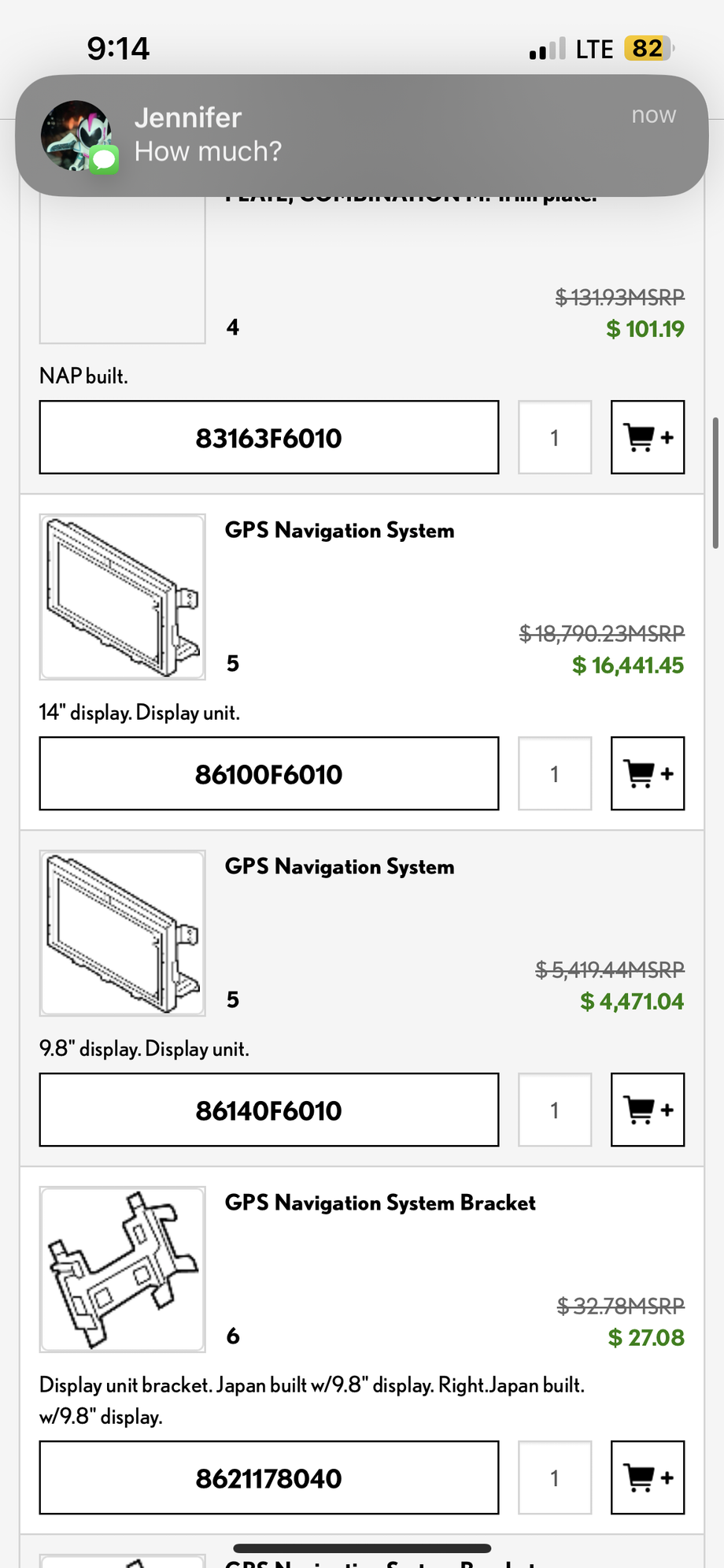

Update: Lexus is replacing the 14" screen. The tech said he expected an ETA on the unit "in a couple of days." When I asked what the typical ETA is to receive it he said, "from a few days to a few weeks." It ships direct from the OEM of the panel, not from Lexus, so I'm guessing it's coming from Asia somewhere. 😟
