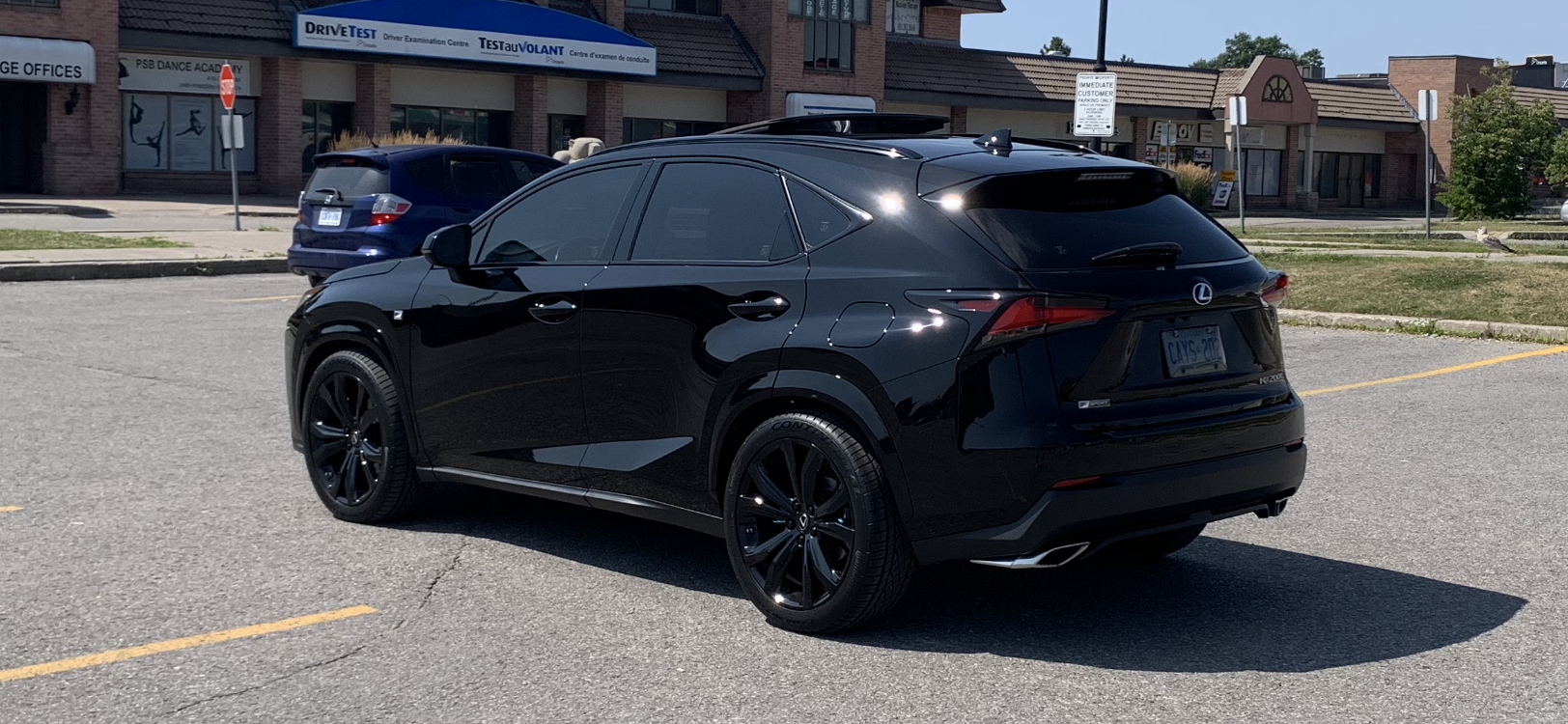

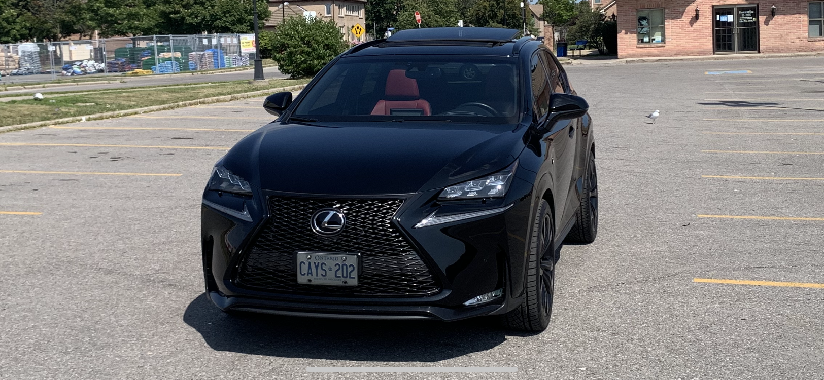

My man, I am also lowered on RSR springs, previously I had the OEM 18inch wheels and 19inch FSport wheels running with 15mm front and 25mm rear with absolutely no issues. Recently I added a set of 20inch RX350 wheels on the ride and the spacers had the car sitting perfect, flush front and rear, but that’s when I encountered the same issue. You have - couple choices, you can cut the fenders ( I don’t recommend), or go with a lower spaced size. I ended up removing mine altogether today and although the looks aren’t as sharp the ride quality is better now as there is no vibration in the car.
For the record I bought Eibach spacers (not the cheapies) and still experienced vibration, not sure why and I understand others claim to not have this same issue but I don’t think I’m going back to them
here was my flush set up

i used a cquartz coating on the well when the car was new. To be honest the pictures are deceiving as they don’t look that good in person

Oh wow. it looks in the pics just like the arches have been paint matched to the car.
