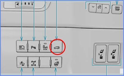

If your vehicle was equipped with a power liftgate, a release switch would be located in the position indicated by the red circle in the attached image. For non-power liftgates, the (mechanical) release is item 2 in the image posted by ISNX.
The release-to-latch linkage may be broken or disconnected. The panel that has been removed in your last image provides access to the latch, but you have to know what sort of tool to use, and precisely where. A dozen "donuts" (a form of currency up here in New England) donated to the technicians at your local dealership (preferably in the morning) will typically result in some instructions from an individual who actually knows how.
According to the service instructions, the liftgate must be open to remove the interior trim panels and access the latch mechanism.

In the image where red circle is indicated, we are quite confident that this has been switched out and that it originally came with a trunk release. As is the same with the key fob.
The trunk hatch handle above license plate does have both the buttons as the image you shared indicates. You can "hear" it trying to function but that's about it.
Ultimately, the conclusion of the trunk door needing to be open to access the actuator was what we ultimately assumed would need to take place but were really very hopeful that maybe there was a way around it, lol.

It is not as easy as you infer to "switch out" just the power liftgate dashboard button. The entire row of 4 buttons is a single assembly (see 2nd attached photo, shot from the rear); it is not possible to replace just the liftgate button with a blank.
