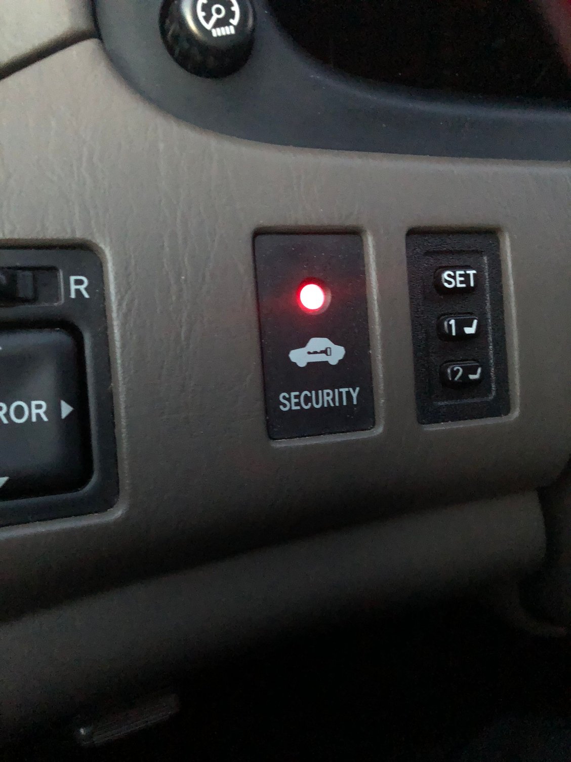

The guy who’s car it is, gave me the spare key/valet key I believe- from disconnecting the negative terminal on the battery and once even setting off the alarm, is it plausible that the immobilizer got tricked on?
ive read of other people having this issue and then using their main key with the programming on it and it turned right over and worked.

As long as the immobilizer light is NOT ON when the key is in the ignotion, it should be fine.
