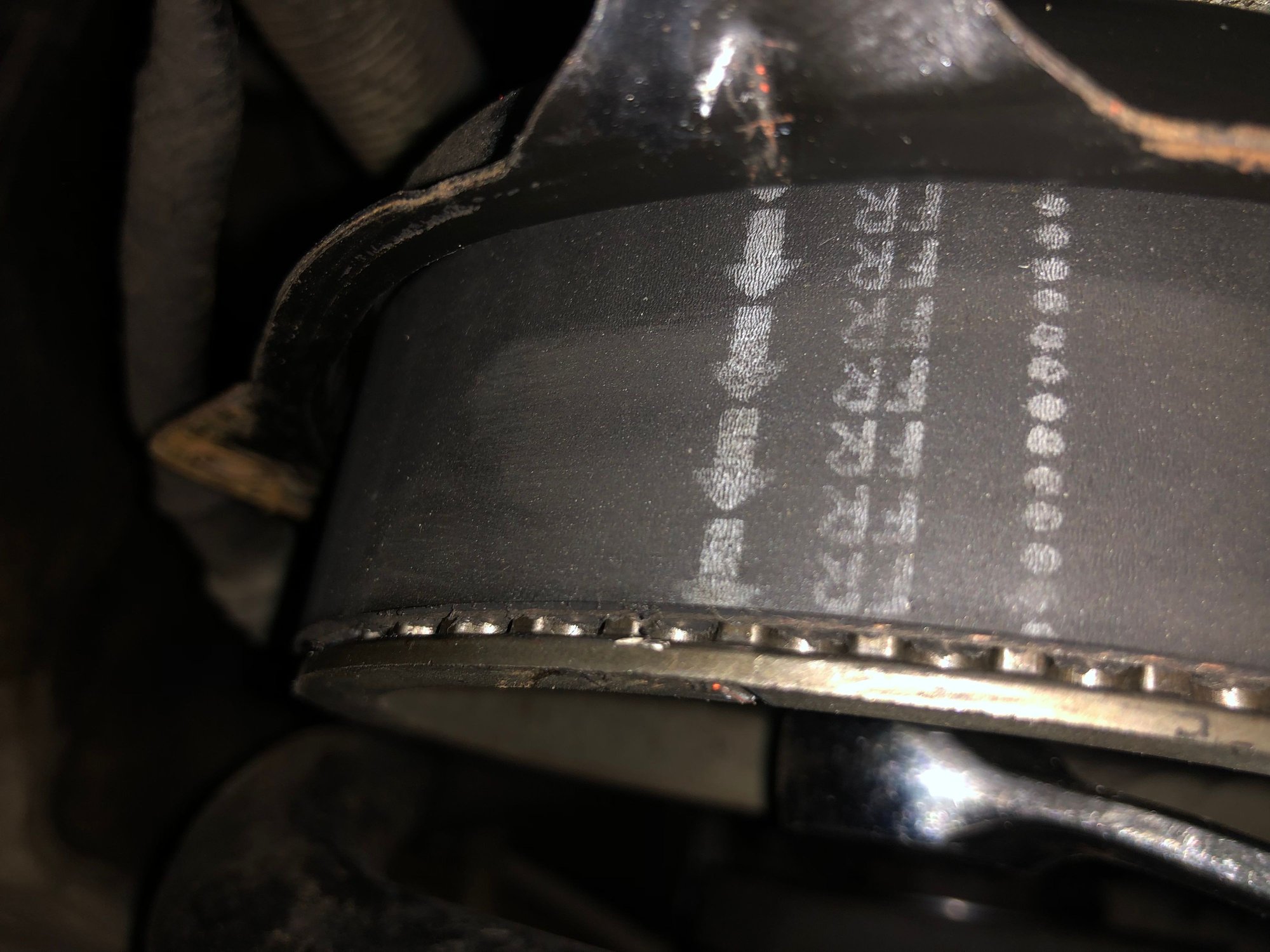

Okay so I got everything off and I got everything aligned perfect with the belt back on and the tensioner in place ready to draw the grenade pin, my only issue now or concern is simply that the slack is in between the right cam, WP, & crank as oppose to the side with the tensioner, when I pull the pin and go to rotate the crank will it mess with alignment?
Old Jan 2, 2020 | 10:12 PM
Nad1370's Avatar
Nad1370
Joined: Apr 2008
Posts: 1,058
Likes: 126
If there is slack, it shouldnt be much that i would worry.
Just pull the pin.
Then rotate the crank clockwise till no slack on the right can to wp.
Then fire her up.

Well Nad, I got the timing dead on perfect, and I’m still stalling after idling. The only differnce was, while I was doing the timing belt adjustments, I put the battery on the battery charger- knowing it was probably weak after all the cranking, and the first start up was really good, idle smooth and I actually shut her down however with each following start up it seemed to get worst. I’m convinced it’s this battery somehow. I don’t understand why it would affect it after starting, but it seems that way.
Old Jan 3, 2020 | 08:53 AM
Nad1370's Avatar
Nad1370
Joined: Apr 2008
Posts: 1,058
Likes: 126
Awesome that you finally got the timing corrected.
That rules out that issue now.
So if im understanding this correctly, cold start high idle — it idles fine.
But when it gets closer to operating temps, idle just falls flat on its face and eventually dies out.
Now you suspect the battery.
Might as well have that tested too just for peace of mind.
I actually ran into that into that similar problem.
Would barely idle so i hooked up a jumper pack on the battery and drove it home fine.
Replaced the battery afterwards.
