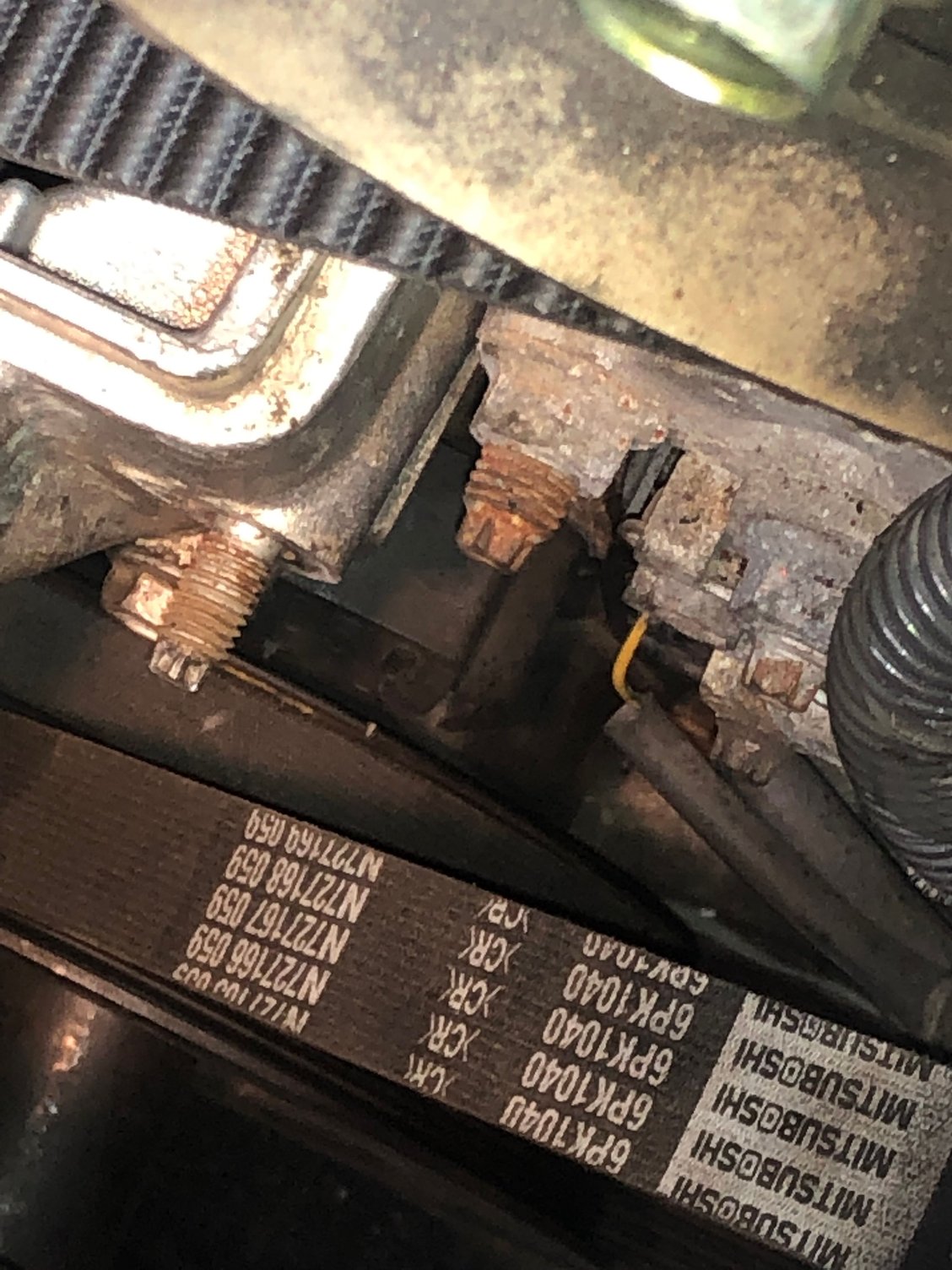

Crank aligned at “0”
Right cam
Left cam, awkward to see but aligned.
So so here are my marks, they seem pretty much on except the right cam is a half or full cog/tooth retard, not advanced. Would this create no idling?

Did those white marks came with the belt or did you do that?
It does look like your Bank 2 cam is off.
But your white marks are on line with the cam gear marks.
If you loosen the 2 12mm bolt off the tensioner (dont take it out), you will get the slack you need. (i did this before)
Adjust timing marks as you needed
Once you advance the right cam a tooth, you're going to do the tightening dance.
Start tightening the 2 12 bolts evenly.
Enough tension on each and repeat till it tightens all the way.
Dont use an air tool, do it with hand tools so so have control on the tension as it goes up.
If you dont feel comfortable doing this, you can take it off and press it on a vise.
