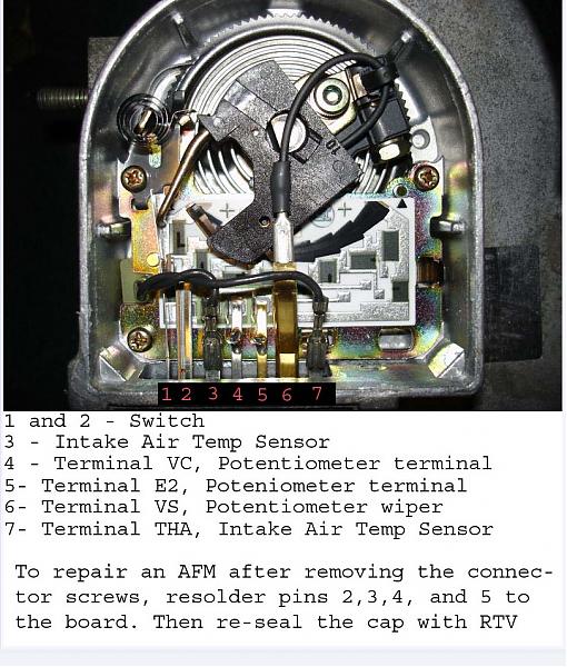

yea its for my friend ... i think we have more knowlidgible people here on CL so i just thought i'd ask
does any one know what would cause the thing below to not work ... its called an 'afm'
any help would be great

what year is it 84-89 they are know to go bad when moisture sets in it.

his is a ~93 or so ... does the moisture idea still apply?

I used to have 91 MR2s, a turbo and a non-turbo. Is your turbo?
If it is junk that stupid AFM flapper system and replace it with a HKS VPC. They are harder to find these days, but a Vein Pressure Convertor will remove tons of restrictions in the intake system.
There was a fix posted for the AFM for people that mistakenly got throttle body cleaner in it, effectively destroying it. Try the MR2 Owners Club website for that fix.

its a turbo ... further investigation into this VPC seems like a good idea thanx for the advice
