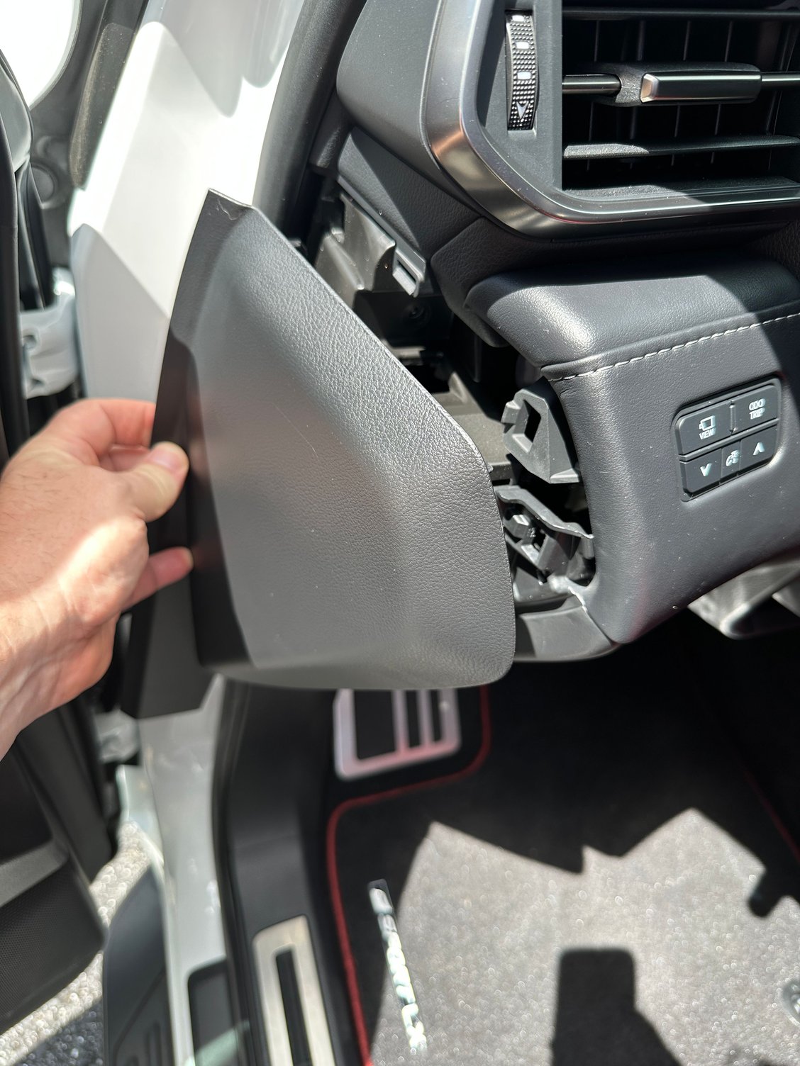

I have some promising news to report: The eBay Auto Start/Stop module I purchased recently, DOES FIT BOTH CONNECTORS ON MY 2024 LX600 !!!
Today I removed the end-piece on the dashboard, using a "spudger" tool. You work the spudger around the perimeter of the plastic end-cap on the dashboard, and its integrated clips will release. You can see this in the photos below (minus the spudger tool).
Plastic end-cap, loosened.
Plastic end-cap, removed.
After removing the end-cap, you will see the following plastic "cage". You will need to remove two silver 10mm bolts, using a 1/4" drive, 10mm socket. You can see the cage here, with the bolts removed.
Plastic cage with two 10mm screws removed.
Then, you want to GENTLY pull the cage forward toward the driver's seat. This will release its clips and give you ample room behind it to access the off-white connector to the rear hatch/Auto Start-Stop switches.

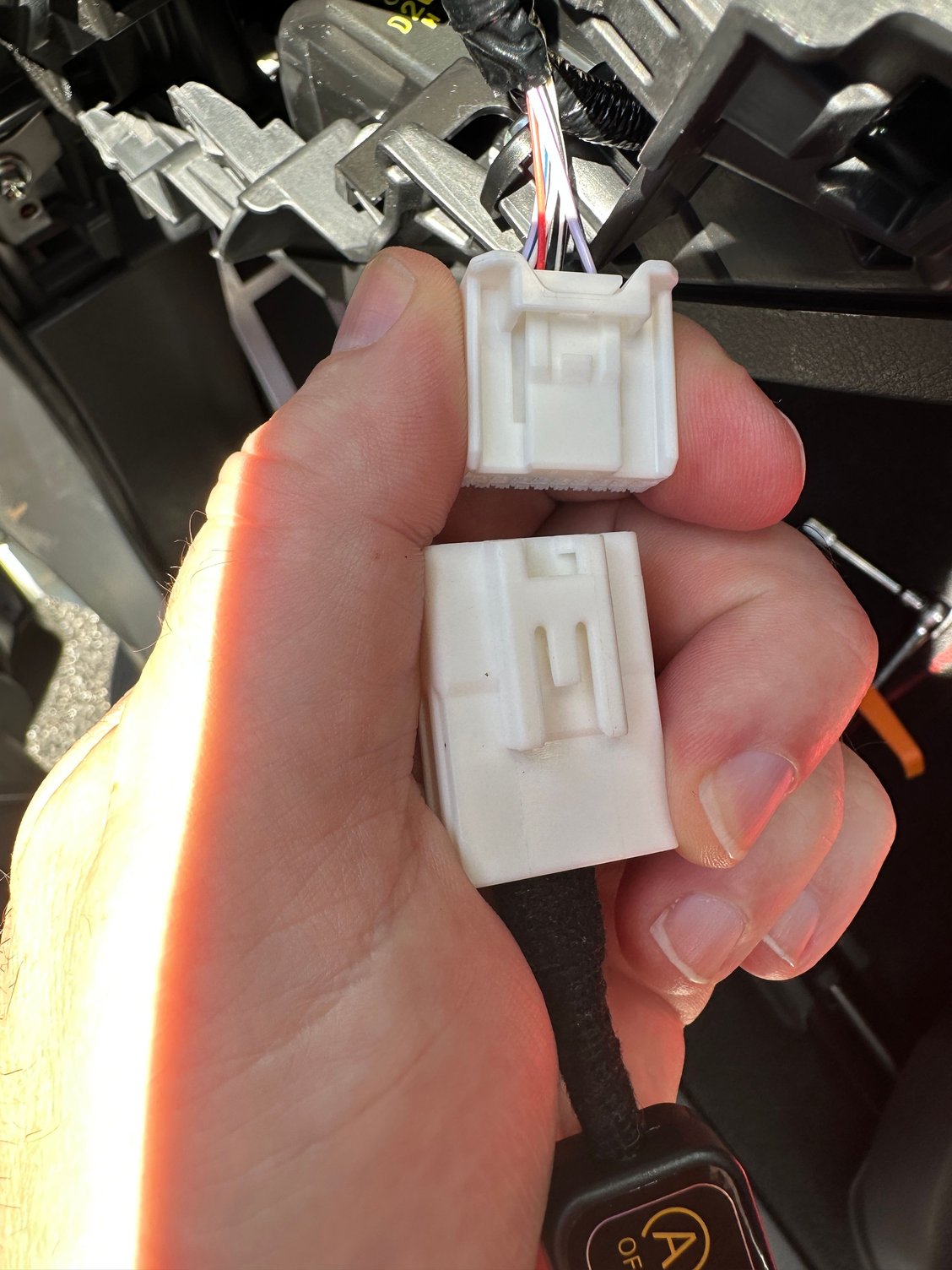

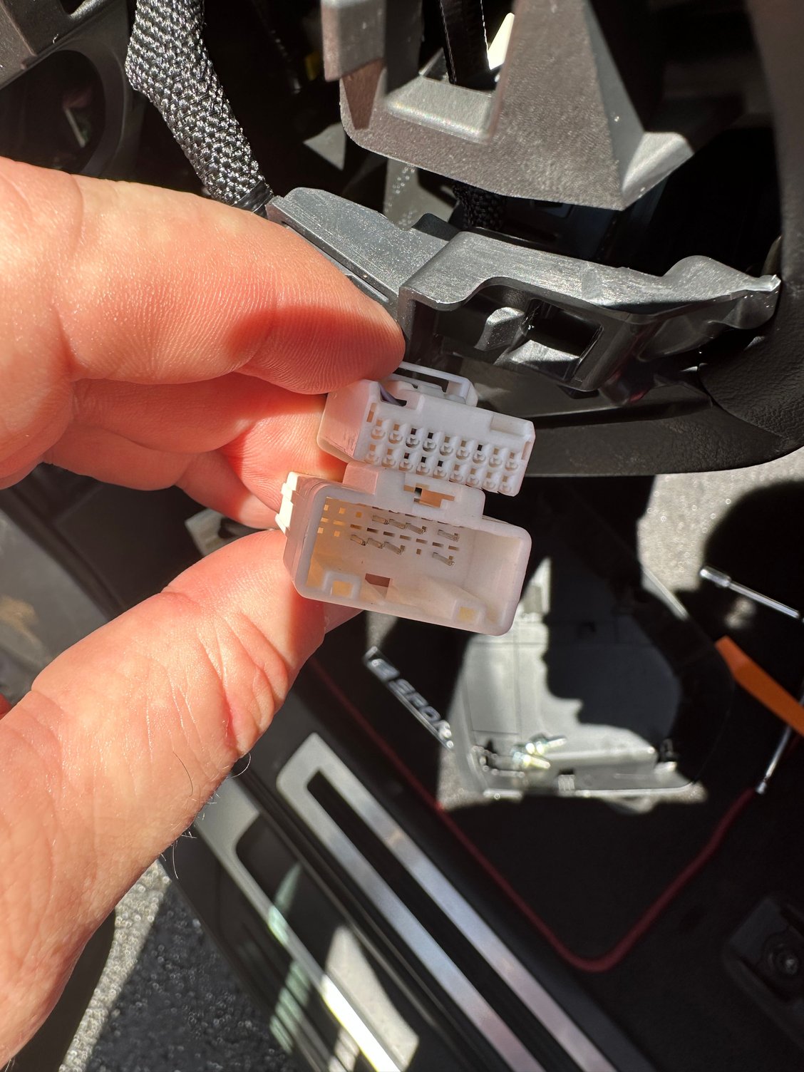

Remove the connector from the back of the Auto Start/Stop switch, and plug in the end of the module's connector. In the photos below, you can see that it is an appropriate match, and matches up just fine.
Comparing the module connector and the Lexus connector.
Getting ready to plug the module onto the Lexus connector.
Plugging the connectors together.
All connected. Now for the other side.....

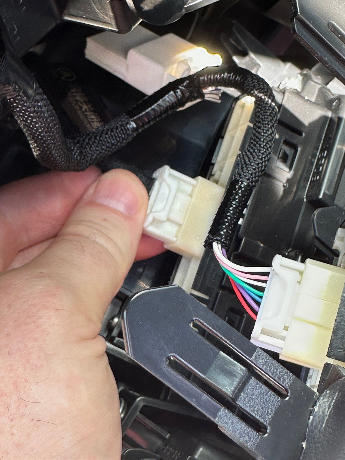

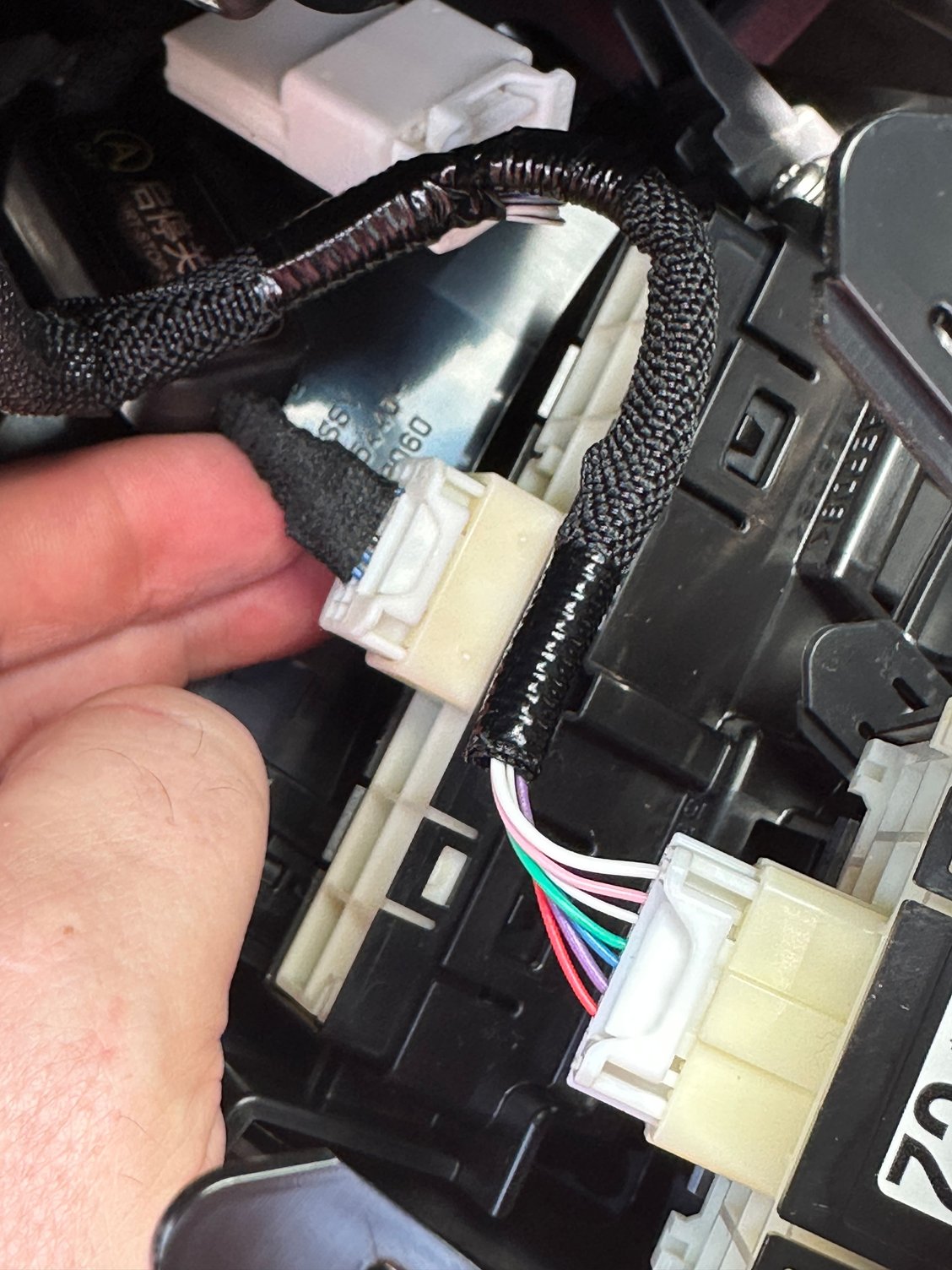

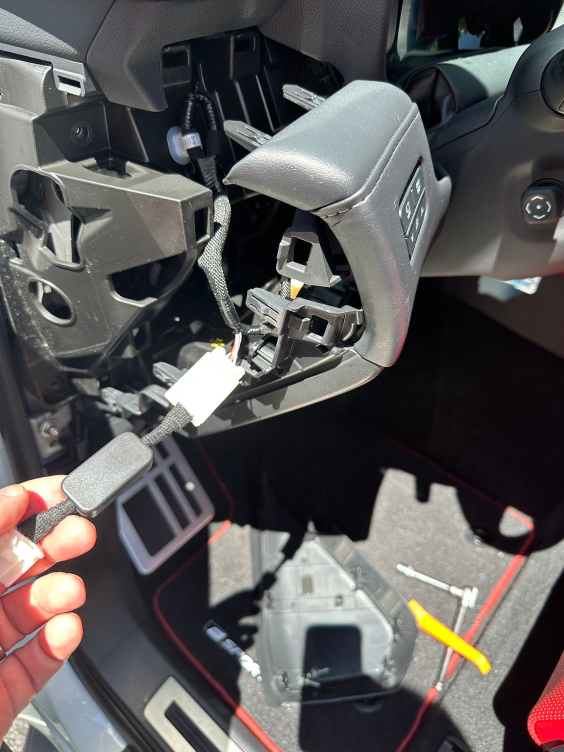

Next, plug the OTHER end of the Auto Start/Stop Module into the connector on the back of the dashboard switch. Again, as you can see, it fits correctly.
Preparing to connect the other end of the module to the dashboard switch connector.....
Looking like it is a connector fit.
Almost plugged together....
Fully plugged into the dashboard switch.
I HAVE NOT yest tested if the module works or not, but will be driving the LX600 later this afternoon.
I did confirm that the rear cargo hatch door switch works fine with the module in place (both open and close functionality).
With the module plugged in, the Auto Start/Stop button does work when pushed and indicates the little symbol in the instrument cluster when the button is pushed, and when pushed again the Circle A symbol disappears. I DO NOT yet know whether the Auto Start/Stop is disabled when driving the truck, but the module being plugged in DOES NOT cause the Circle-A to be displayed.

Following up on this, I took two different trips out this afternoon around town, with plenty of start and stop traffic. Bottom line is that this Auto Stop/Start dongle, though its connectors do fit the LX600 correctly, DOES NOT disable the Auto Start/Stop function.
I could only disable the function by hitting the button on the dashboard, or by modulating my foot pressure on the brake (don't press too hard), or at a few points when the climate control system was running. Same as normal.
The only thing different I noticed with this dongle installed, is that it does activate the "ECO" green logo on the instrument cluster. Otherwise, ZERO effect.
So, back to the drawing board. Hopefully someone can design a product that actually WORKS.
In the meantime, I will return this product via eBay. It was worth a try......
