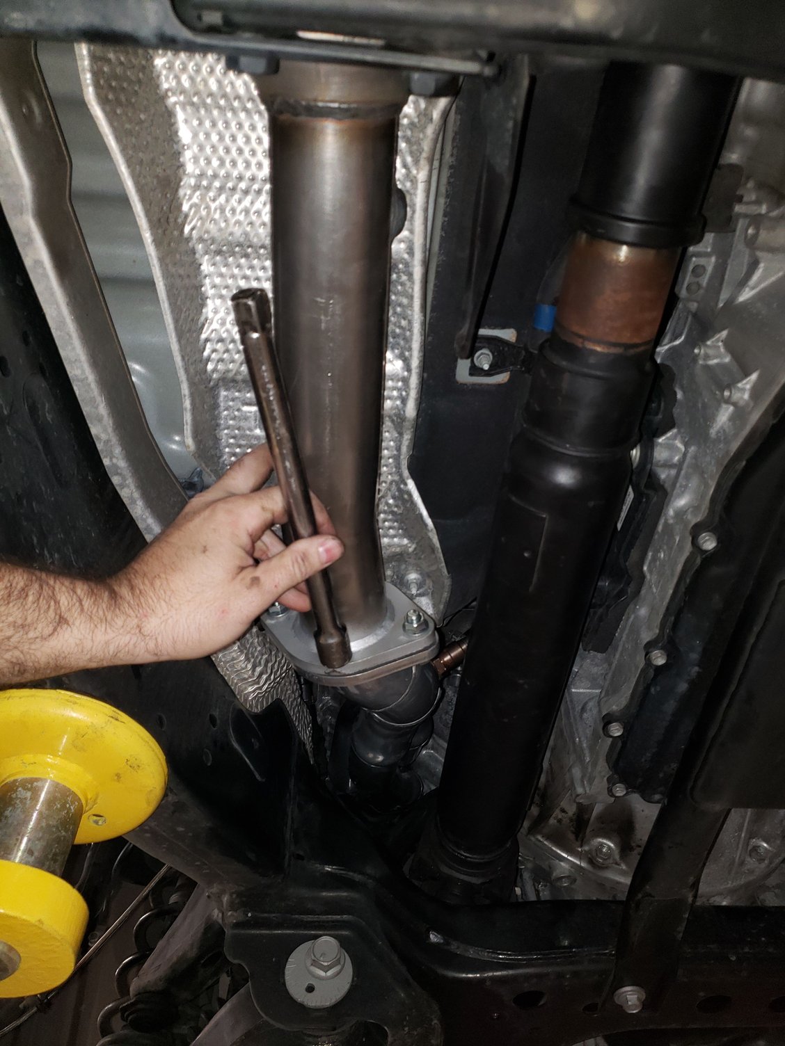

To get the factory B pipes out, you need to remove the downstream o2 sensor on both, remove the muffler and drop the cross member and inch or so on the passenger side:
So after lots of lifting and dropping the truck I finally got the pass side header out (which is probably the easiest one) - this is not for the faint of heart and was way harder than when I did long tube headers on my old 2008 5.7 Tundra. The AHC BS is in the way all the time and whenever it isn't. the motor mounts is then in your way. Have every 12mm socket type in existence on hand or you're going to have a bad time.
