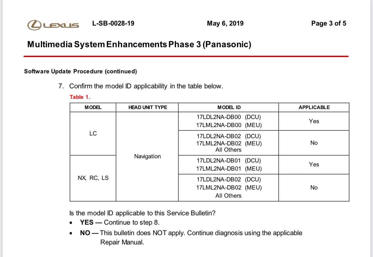

NOTE: Be aware that it does state in the LSB that certain versions are unable to receive the update

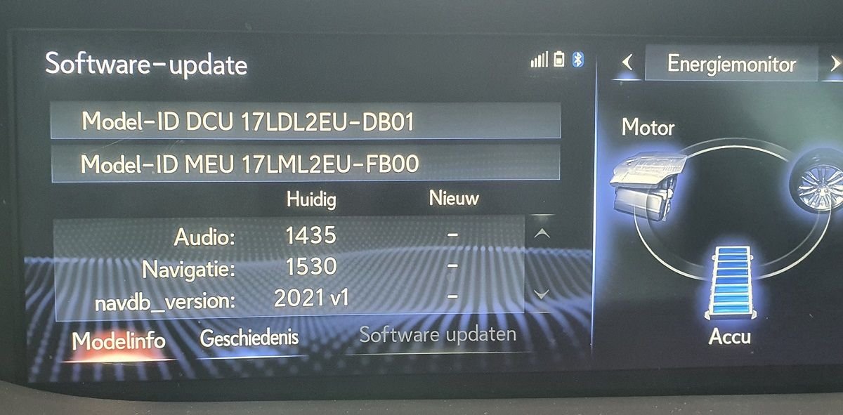

damn...mine is DCU: 17LDL2EU-DB01 and MEU: 17LML2EU-FB00.
From which date is this info? Is this the last word from Lexus for today?

A US bulletin doesn’t apply in Spain, they are country specific.

Quote: A US bulletin doesn’t apply in Spain, they are country specific.
exactly... that's what they are saying to me here ;-)) and This is the whole point no one can explain to me what is the difference between Lexus LS 500h, sold in America and Europe? Do japan dudes make different Lexuses for those countries?

Quote: i see theres is a TSB where can i find my Model ID
(My menu is in Dutch)
Press Menu,
Settings,
Scroll down to "software update"
Reply 0

Hi all! and so I was preparing for half a year )))))) I live in Europe and I have the American version of the LS500 2018.04 already with the o-manual disk and I just made myself a carplay from official updates, it was not difficult, but it took about 2 hours with the engine running ^ the main thing is not to take more than 8-16GB of usb and change its name to USB Drive. PS It was easy to switch the light 3 times )))) without this, the update will not start, the main thing is to correspond to servis bulletin

Service Bulletin - https://static.nhtsa.gov/odi/tsbs/20...62736-9999.pdf - use it there is an additional photo about files on usb!
Updates - https://drive.google.com/drive/folde...kACDpPj0GHAkxB
​​​​​​Basics:
-Use a high quality 8GB flash drive
-Drive *MUST* be formatted in Windows using FAT32
-This update will stress the drive and may overheat the flash drive causing the update to fail.
-You may use any USB HDD/SSD, as long as the first partition is MBR, 8GB, FAT32
-Most common issues are flash drive read errors, overheating, and format issues
-The documents explain the recovery methods
