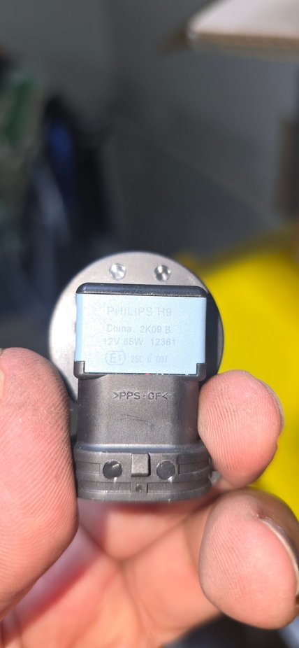

I just fixed mine, the $4k new replacement headlight (LED) from the stealership came with a missing halogen lamp !!!
The lamp is an H9 12v 65w. 20 bucks at oriley auto parts, I took the one from the other headlight to confirm.
The space is a little tight, but doable without having to remove the bumper/headlight.

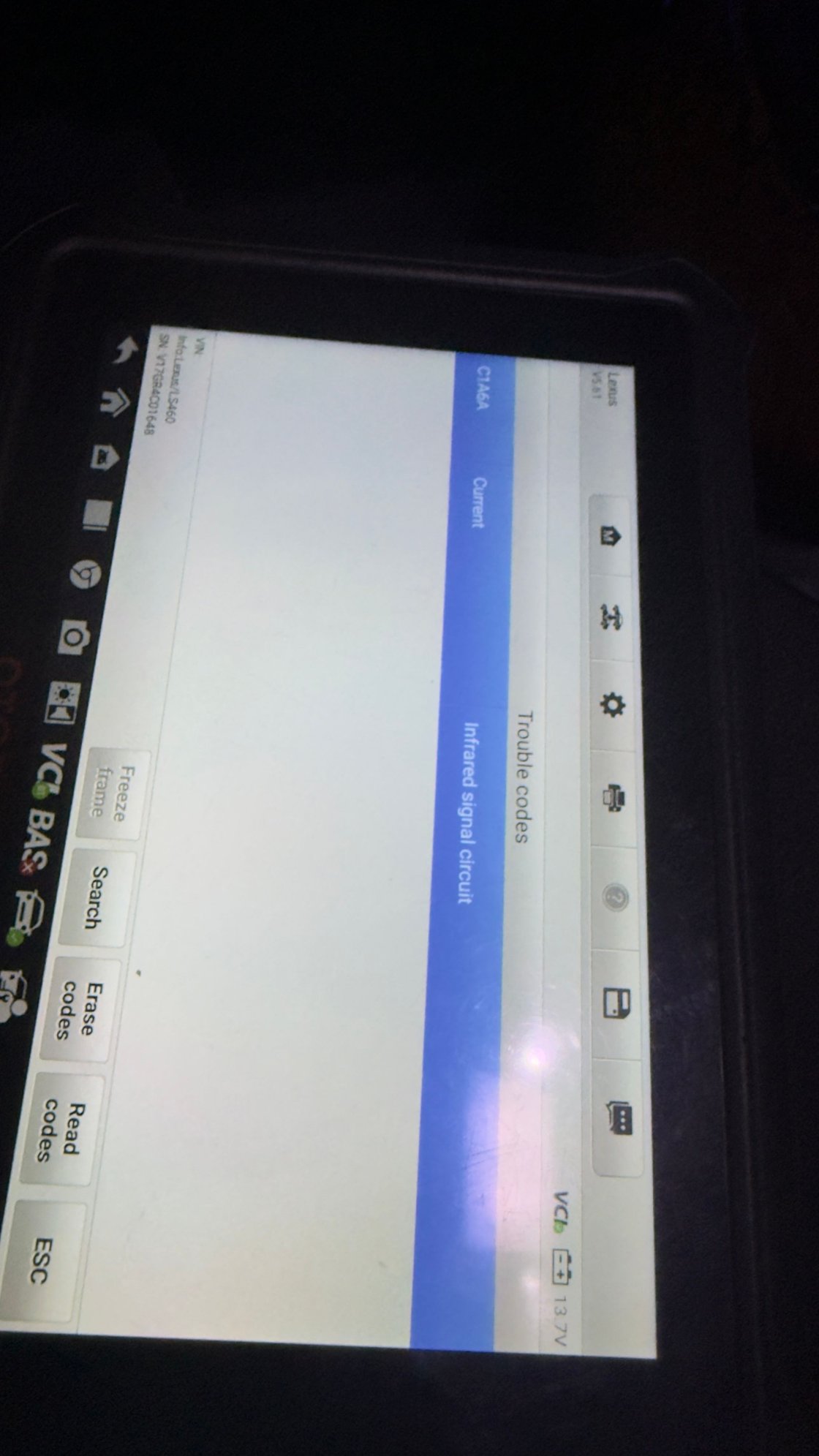

Hello everyone,
For about three months, I’ve been trying to find a solution to the same issue I’ve been having with my car. After a lot of searching, I finally thought I’d found the answer: I bought two halogen bulbs, since they were missing ever since I bought the car and I didn’t know what to replace them with.
After installing and securing the bulbs, I still had the same problem. When I drive at night and reach a speed of 20 km/h, the PCS warning appears — even though the halogen bulbs are properly installed. I checked the car’s computer and saw the same fault code (C1A6A) still showing.
I also tried activating the halogen or IR lights through the car’s system — and they actually worked perfectly. When I press the “on” button, they turn on; when I press “off,” they turn off. Everything works fine, but the moment I activate the IR lights, the PCS warning pops up again.
I’m not sure what’s causing this, but I noticed that the right-side light is higher than the left one. I suspect the alignment might not be correct. Even so, the night visibility is really poor.
I’ll share some pictures and videos soon — I really hope someone can help me figure this out.
Important note: It works perfectly fine and doesn’t show any errors or cause any issues — but only if I keep the high beams turned on
