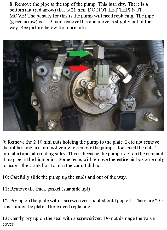

Why not just reseal the pump? There is zero guarantee that a used pump was removed in the correct fashion.......it may leak at the same place. Salvage yard guys range from master tech skilled to guy with hammer and sawzall
When the pump is damaged in the location where his dealer suggested, the pump cannot be fixed / resealed. If I remember correctly there are warnings in the manual not to rotate that nut. It is not meant to move. The fitting in that location can be very tight. Even while using a backup wrench on the stationary nut it is difficult not to put torque on it while you break free the fitting.
Your absolutely right...
The replacement pump may leak too, hence the 30 day return window. It's worth the risk imo.
This is a good write up by Fblonk
https://www.clublexus.com/forums/ls-...placement.html
From what I understand this is where the ops pump is leaking. ( red arrow)
Oh, I thought they moved the 19 a bit. Yeah it's best not to play with the lower one if you can avoid it, test it out and see if the new one is good. If not send it back until get one that was removed without disturbing the lower one
Definitely. This is where I pulled the picture I posted earlier in the tread. Great information and I am passing this along to the mechanic whether he knows or not.
I have put him on high alert.
