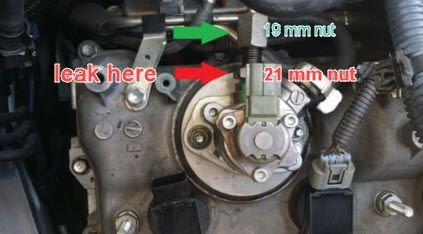

Update:
So thankful for the this forum. So there's a leak at the driver's side HP fuel pump where the 19 mm nut is located (the one that you're not supposed to move) on the fuel pump.
image taken from user fblonk post on replacing fuel pump gasket for diagram purposes only. LINK: 460 Passenger side fuel pump gasket replacement
The dealership was able to document this and give me a good write up on this possibly happening when the previous mechanic replaced our valve cover gaskets. I relayed this information to the mechanic and he admitted to probably doing this. (which is stand up by him) Now this leaves me in a pickle.
