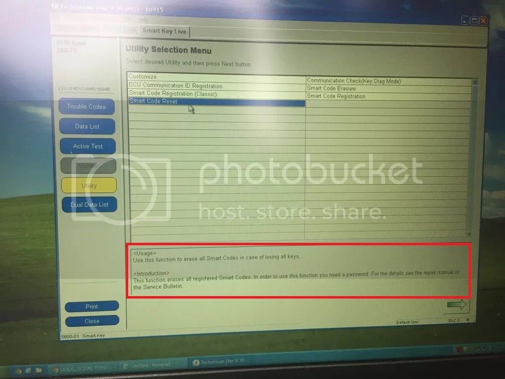

I noticed in techstream there are two options for "erasing" smart access key codes. I lost one of my key fobs and want to erase all the key codes and program only the remaining key fobs I have left. There is a "smart code reset" and "smart code erasure" option. What's the difference between the two and what is the exact steps I need to perform when erasing all keys from my car? I want to make sure before attempting so I won't be stuck with an car I can't start.
I have a 2007 LS460.

If you single-click on each option, you can read what it does in the help window below.

I just did this recently when I thought my wife list her spare key which she later found. I purchased a new key online and with my remaining master key I erased ALL keys then added the new key. This reminds me that I have to add back the key that was later found. I used the erase key method. The test method is for when ALL keys are lost and the dealer needs to reprogram the ECU to accept a different key code.

Yeah i see the descriptions at the bottom but I wanted to know exactly how the procedure is performed, like does the erasure option require passcode?

I believe, "all keys lost" and "add a key" (used) require a passcode. If you try adding a new key, it will require a master key, I believe. By experimenting with adding keys, you should be able to figure which is the master key. I am not sure if it is an option for you.

Yes , adding additional virgin key dont require passcode. But all keys lost requires a seed code that can be bought online.

A master key is any key that will start the car, pop the truck and open the glove box. Not necessarily the key that the car shipped with. You HAVE to have a master key to even start the process so there's no chance that your key will be erased. It's all very simple but I feel your anxiety. Once you erase all keys then the key that you started the process with will become the only master key. From there you can just add the new key and that's it. It takes all of 10 minutes if that.
