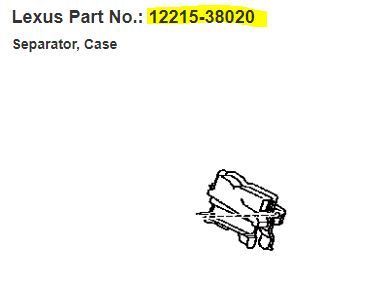

Is this the separator you refer too? Also I'm not seeing a separator to block seal, got a p/n?
Old Aug 23, 2022 | 03:36 PM
  #338
Boykie's Avatar
Boykie
Joined: Sep 2021
Posts: 1,145
Likes: 602
Yup, although thing in this pic is nothing like real thing. PM me your vin for part numbers.

Separator case 12215-38020 (google image search this no to see pics of real thing. it's rather big)

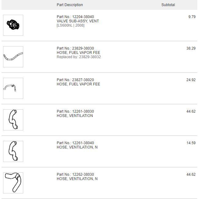

I ordered the additional parts. Funny how the used part on ebay is $$$. They tack on a few extra dollars for the clamp and hose
That pcv 12204-38010 didn't seem to be applicable to the 600. I had already ordered this one 12204-38040

My bad, absolutely. 12204-38040 is the correct one for 2UR. And yes, ebay is a funny place. That valve is probably worn, hose is just too wooden to come off and separator is in unknown capacity.

Parts ordered so far...
