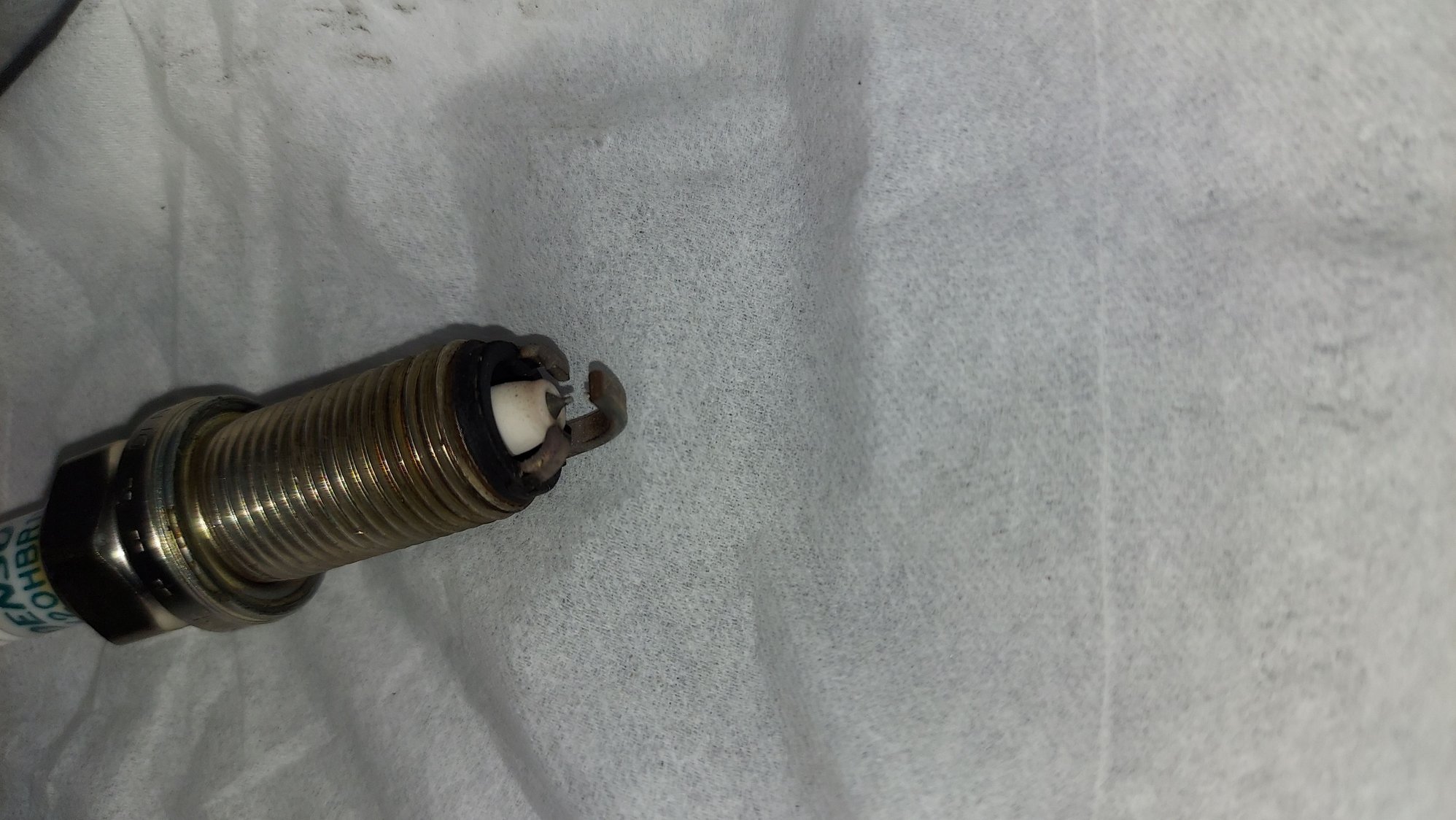

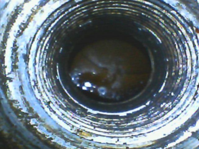

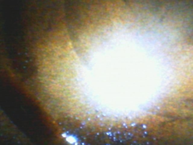

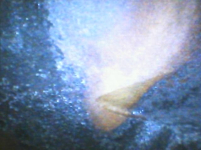

I don't know why I didn't think of this yesterday. This morning I dipped my borescope in the puddle of oil on top of the piston. It's the consistency of a thick oil. It didn't smell like gas.
Here are a few more pics for your viewing pleasure. First few are my 460 piston with 193k miles.
460
460
460
460. This car does burn a bit of oil .5 to 1 quart every 5000 miles.
460 spark plug with 20k miles. This plug gap is much wider than my 600. I'm not sure which is normal.
600 spark plug hole. I dipped my borescope in that puddle.
I attempted to get a sample from the area on the left.
This is my borescope oil sample. Best description... a sticky oil.
Old Aug 23, 2022 | 10:35 AM
  #330
Boykie's Avatar
Boykie
Joined: Sep 2021
Posts: 1,145
Likes: 602
Those plugs are gone. Top electrode gone.
Ok, if it's oil - PCV first to check. Check intake for oil puddle.
How does your engine sounds? Any clatter?
