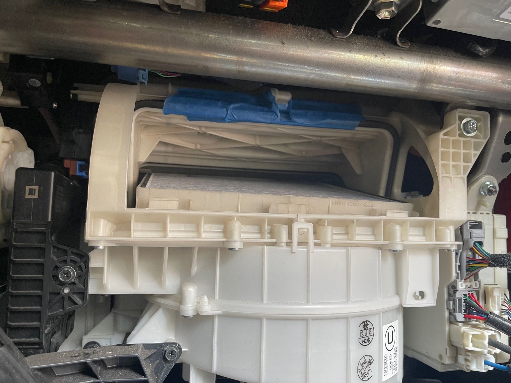

Adding to this thread as my recirculation stopped working and it wasn't because the plastic linkage was broken. My servo motor stopped working and as a temporary fix I separate the plastic arms that connect the door to the servo motor by using a screwdriver to pry the pin out of the slot it rides in. This allowed the door to move freely again so I used some masking tape to hold the door in the air recirculation setting (door up). I found the servo motor sells for just under $200 and I could get it for about $150 but I'll see if the tape holds. Living in Texas, I never intentionally set it to let in outside air so except for occasional fogging of the windows in the winter time I don't need to be able to allow in outside air while driving. Pics below are after the previously linked instructions are followed to get to the plastic linkage. In the first pic, the linkage is separated already. I used a screwdriver where the top arrow is to pull the pin from the other piece (bottom arrow). Next 2 pics show where I used some masking tape.
linkage already separated and door open
masking tape holding the door open
