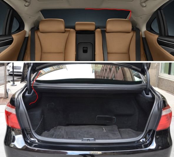

There are actually three fuseboxes in the trunk:
Of these, box A has fuses for such things like cigarette lighter and power outlet, one of which I would happily tap. Box B has 30-180A fuses for bigger stuff, box C has a main 200A fuse.
I was hoping it'd be possible to route the cable like this somehow:
Haha
i would run it behind the rear seat and through the ski pass through
Unfortunately I have a fridge/coolbox there, and with the hybrid battery and rear seat climate control things, I'm not sure any LS600h has a ski passthrough.
