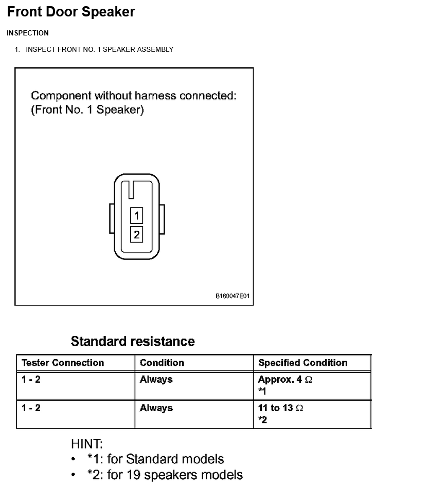

ive done some research, it doesnt look like all speakers are 8ohms. some are 1, 4, 6 or 8ohms. looking up on alldata.

Posts: 27
From: MO
Old Oct 19, 2019 | 02:34 PM
CJWalton's Avatar
CJWalton
Posts: 3
Bro thank you for the help. Idk how I didn't find that. Many thanks.👍

the front door speaker has an impedance of 11-13 ohms according to the service manual. Is it possible to even get a 6x9 speaker with that much impedance?
