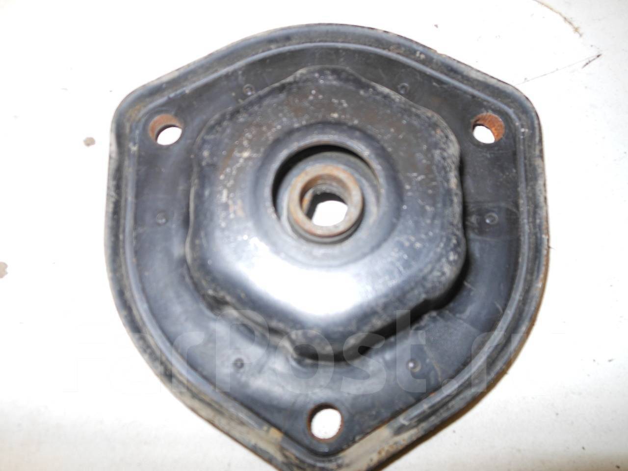

yeah ok idea scrapped.. you guys have seen photos of how the air struts are right, some people like mine... fail where the concave is on the area that mounts.. to the car at the top... I have idea...maybe because it is too thin and the strut itself rises and after a while heat etc... the thing fails around where it keeps pressing up... this is not the exact photo but it kinda fails like that... I wonder whether the top can be opened up and maybe a thick piece of metal or rubber cut ot the exact shape glued with something like window weld.. will make it last longer? or maybe that is a way i can temporarily fix it.
