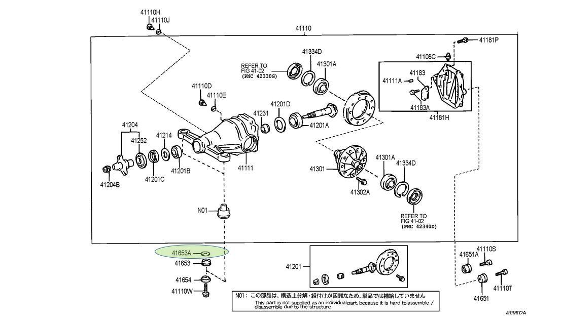

I did some digging at lunch:
Here is the LS460 rear differential mount exploded view, there is a selective washer 41653A marked in green that is available in 3 different thicknesses, 1.0, 1.6, and 2.0mm. This washer goes between the top part of the differential mount cushions and the frame. Thinner 41653A washers move the pinion nose up, which is what we need to eliminate the vibration:
Part numbers for 41653A:
1.0mm washer: 9020115020
1.6mm washer: 9020115028
2.0mm washer: 9020115021
