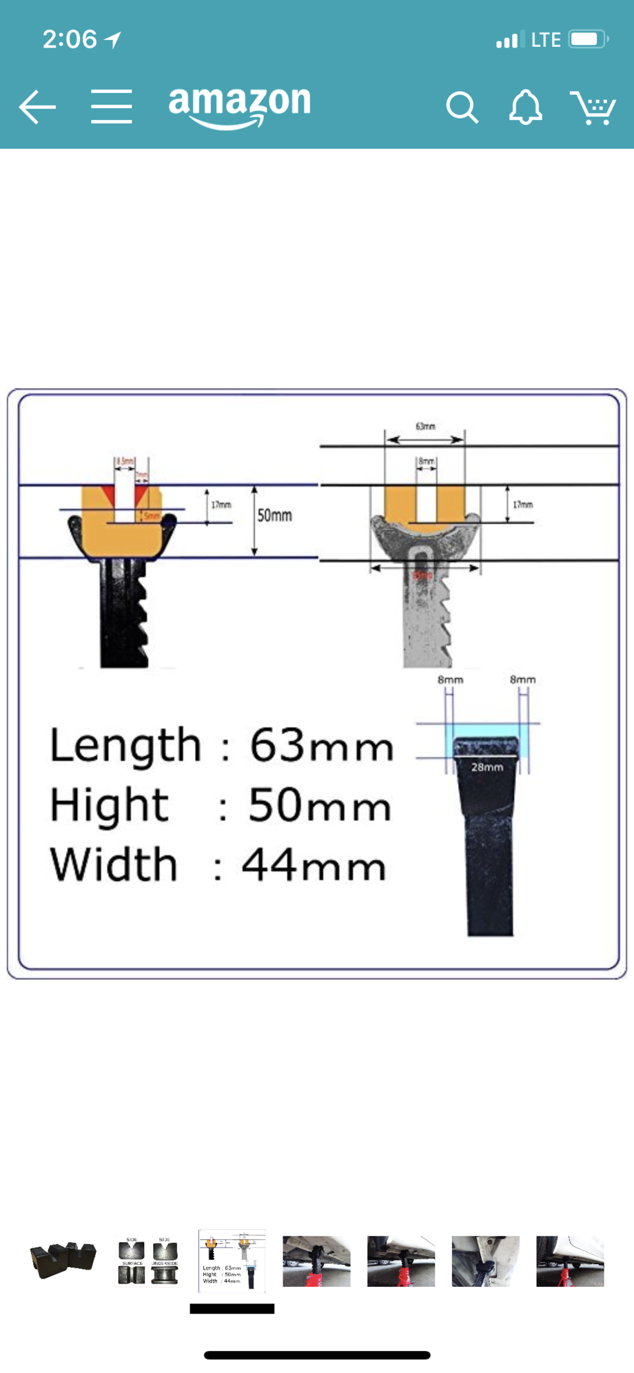

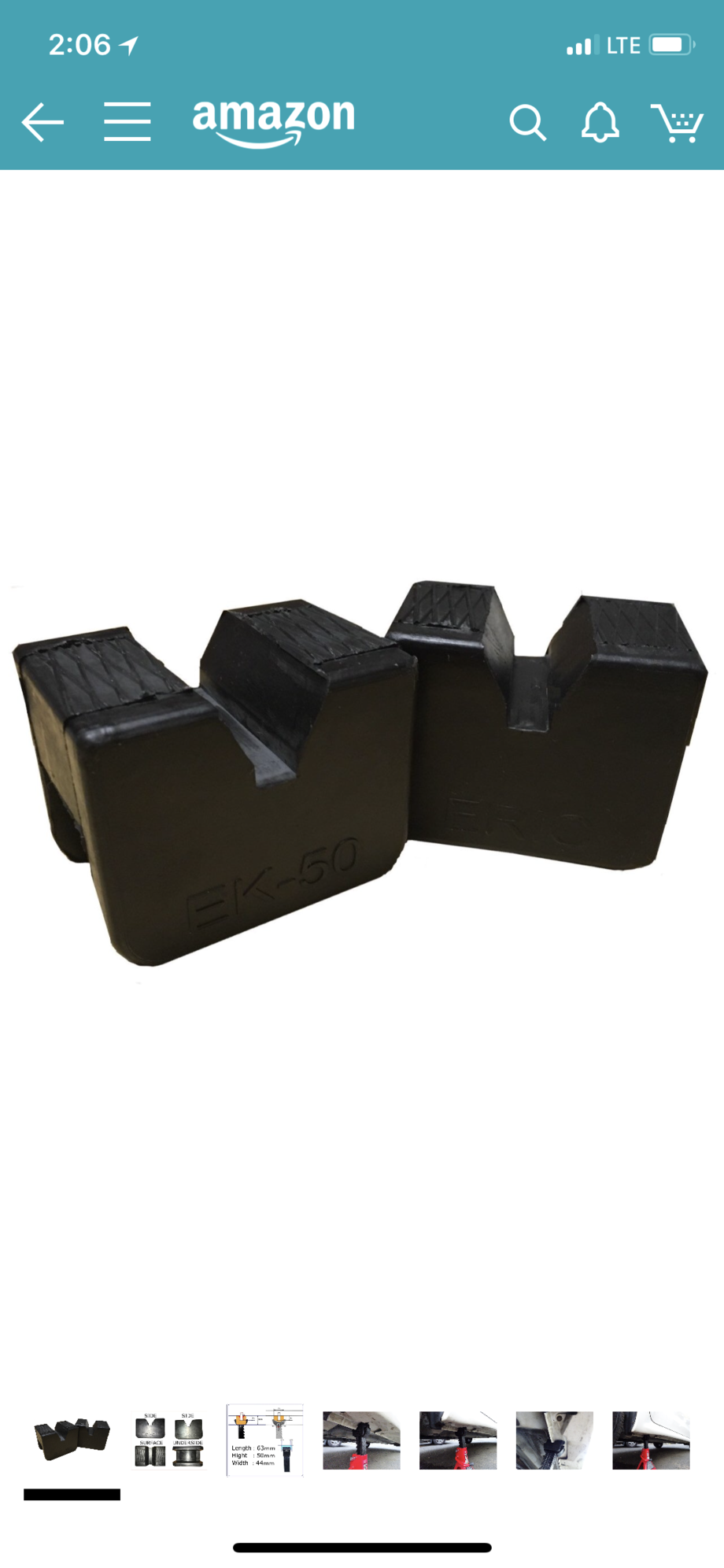

Buy some ramps at your local store. Do you have a large service jack or a small one? You need a large jack to use the pucks which you can get from Amazon. Invest in these if you can do oil changes or any general maintenance.

Bought two pairs of these puck looking things from amazon. I plan on jacking up the car from the two front and rear center points of the car and then jack standing them on the four corners with these. Since some of the corner lips are a bit bent I’m hoping they will work great.
