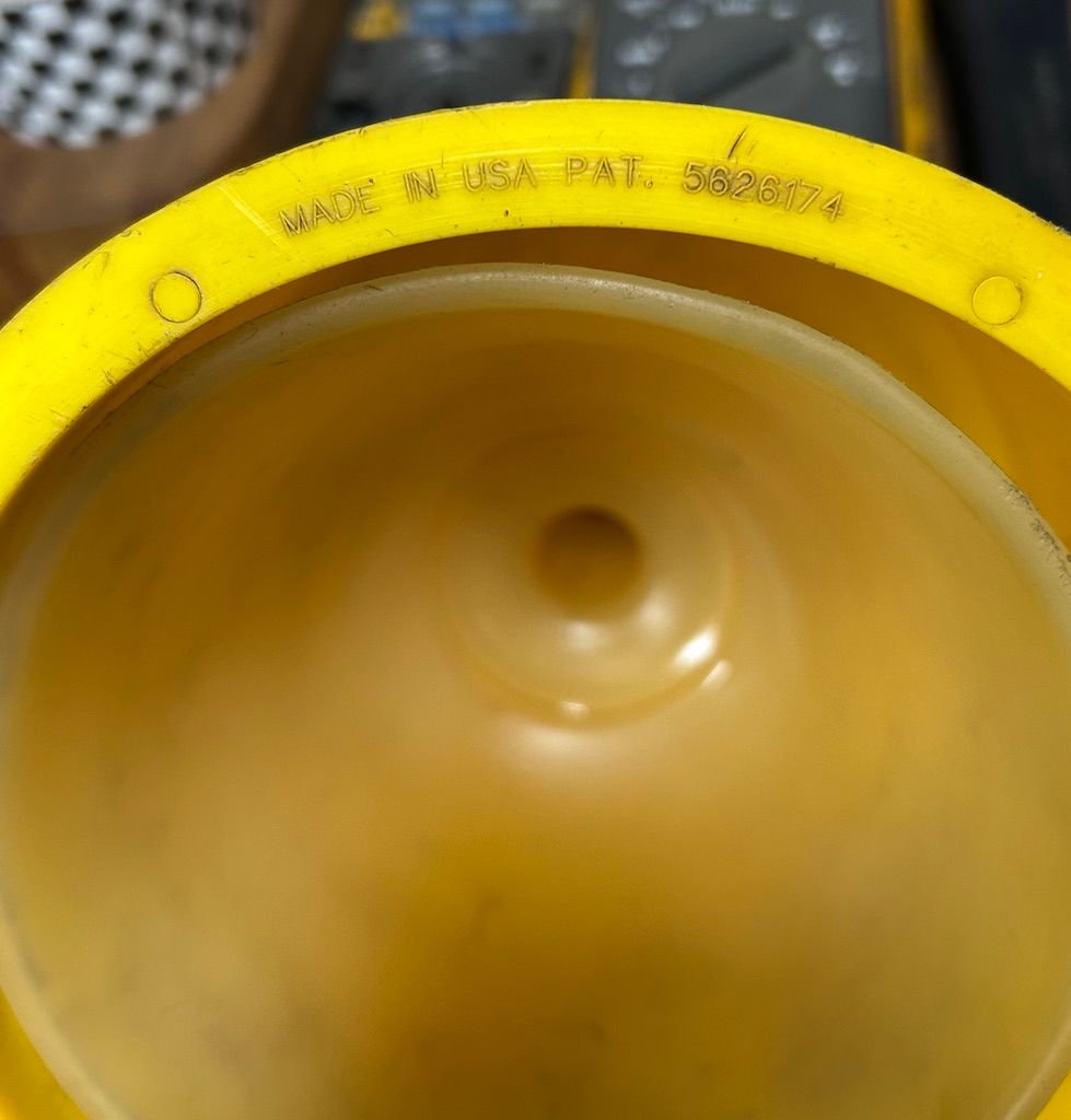

This is the easiest and most efficient way to fill if you don't have a vacuum refilling system, you are just creating a vent at the highest point in the system for the air to escape through. My ez- fill funnel fits perfect in the reservoir. The arrow points to the hoses, either one would work.

@Protholl I'm not sure if you can get these anymore but they are very good quality, had to do a title search to find the brand "Lisle" made in the USA patented in 1997...I knew I had it for quite awhile.
https://patents.google.com/patent/US5626174A/en
