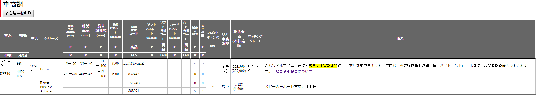

Originally Posted by TofuMan
​​​​​Thanks for helping me find options, when I try the rsr site I'm still only seeing rwd option, am I doing something wrong? Google is only translating some of the Japanese for me, but only showing FR chassis
Odd, when I input the data for an LS460 it gives me both options. Here's a screen shot.
I'm sure there's vendors here that have an account with RSR; however, in the off chance they don't, PM me and I can put you in touch with someone who can get them.
