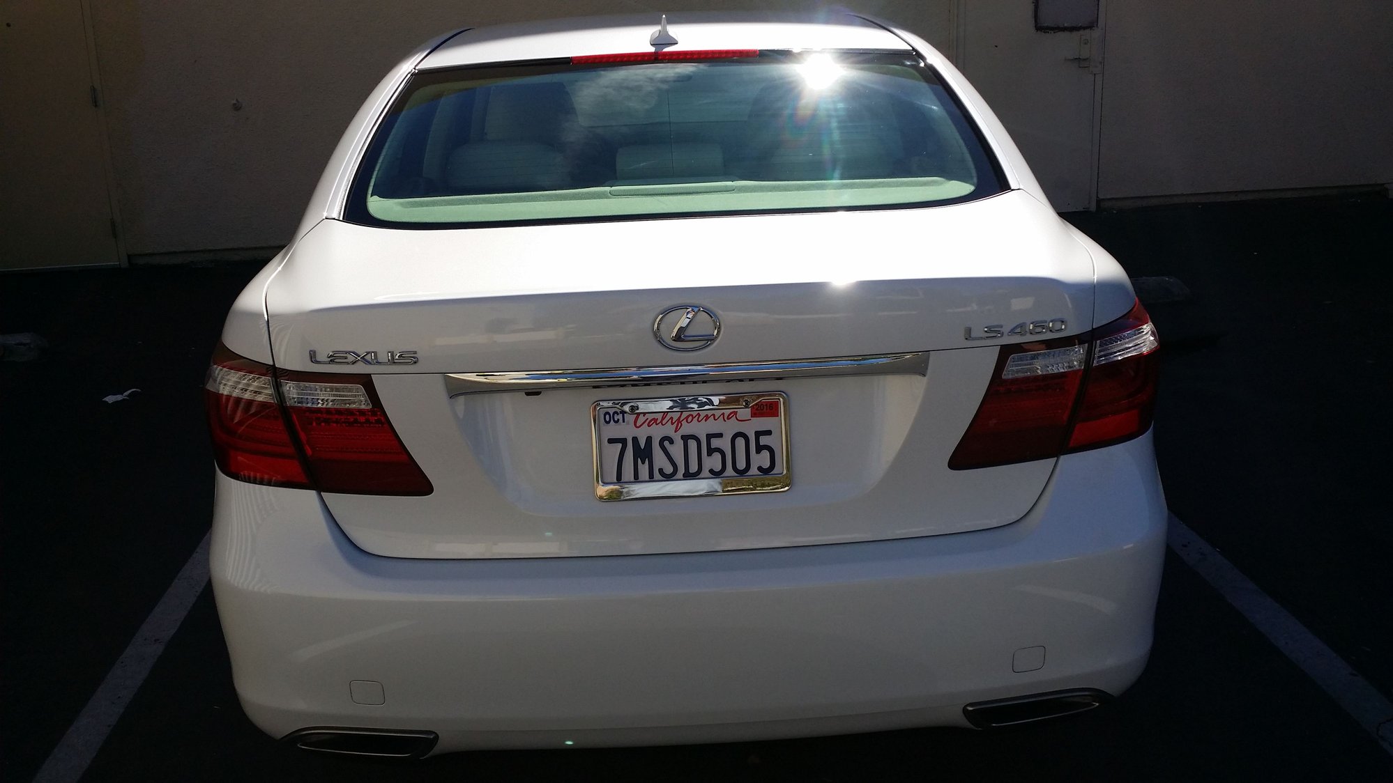

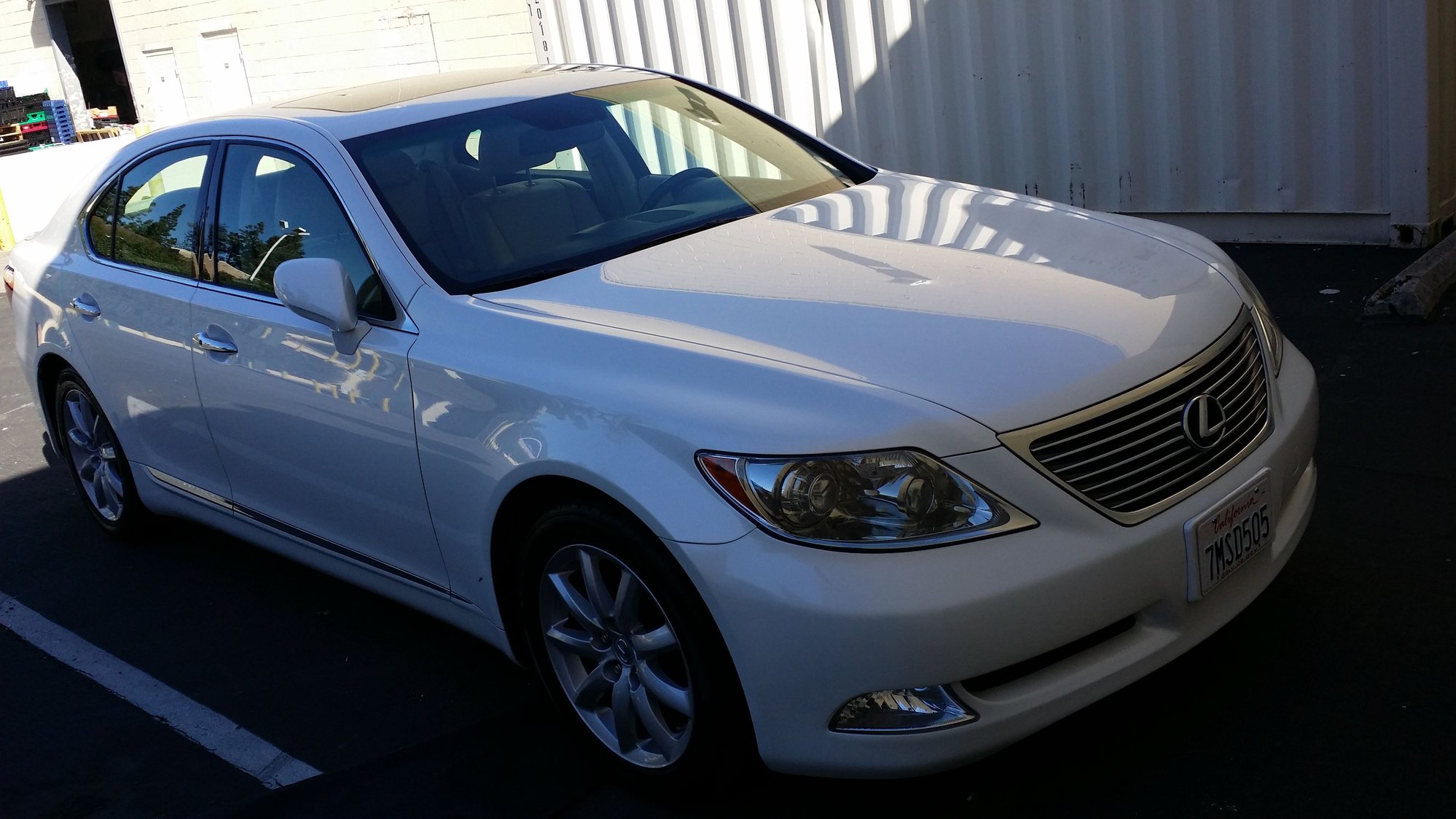

Old Nov 5, 2015 | 12:48 PM
  #57
dkang76's Avatar
dkang76
Joined: Mar 2010
Posts: 117
Originally Posted by mha002
grats on ur pickup!
Thanks. After $300 auto detailing, took some shots. Car looks and feels brand new now. Just need wiper blade insert changed and all done.
Looks new inside.
Old Nov 5, 2015 | 01:08 PM
  #58
dlbuckls10's Avatar
dlbuckls10
Joined: Aug 2014
Posts: 1,423
Likes: 103
Clean and shiny as if it just came off the showroom floor. A nice 460 to be proud of.
Old Nov 5, 2015 | 01:51 PM
  #59
Nospinzone's Avatar
Nospinzone
Joined: Mar 2007
Posts: 4,264
Likes: 481
From: MA
Wow, car looooks maaaaarvelous!
Congrats and I wish you good luck with it.
Old Nov 5, 2015 | 11:10 PM
  #60
dal20402's Avatar
dal20402
Joined: Aug 2015
Posts: 345
White/ivory gives a real old-school Cadillac feeling (and I mean that in a good way). Decadent and opulent.
