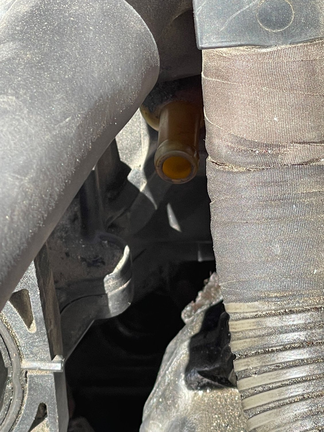

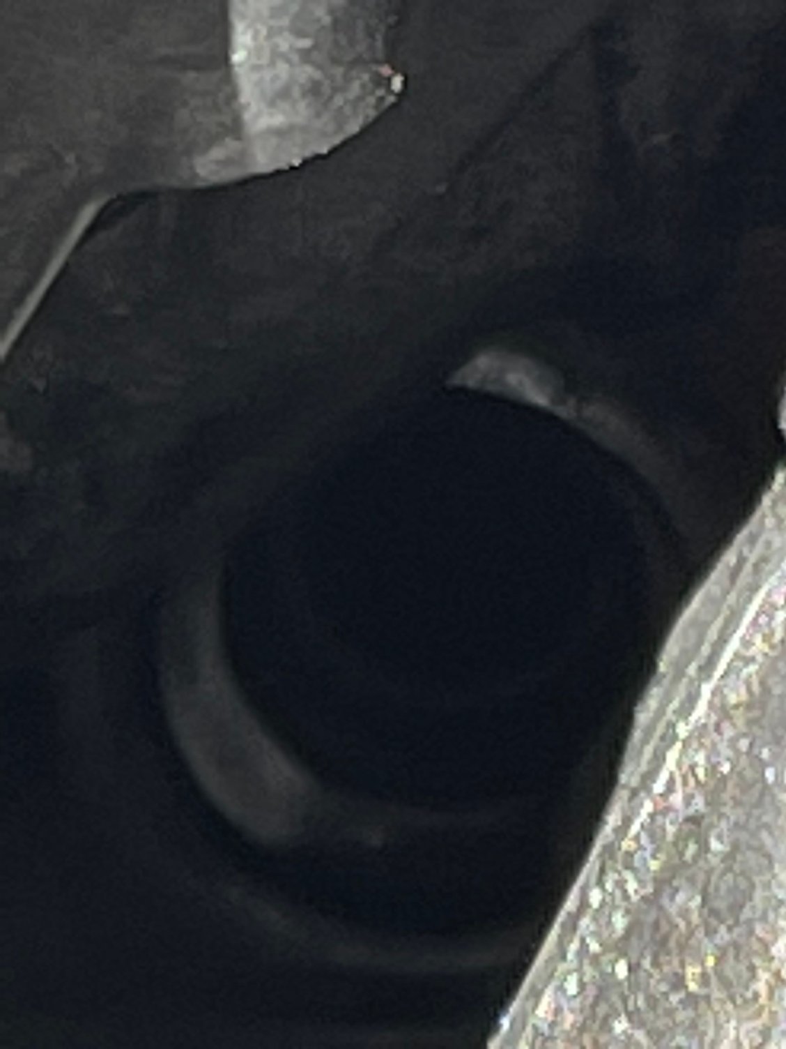

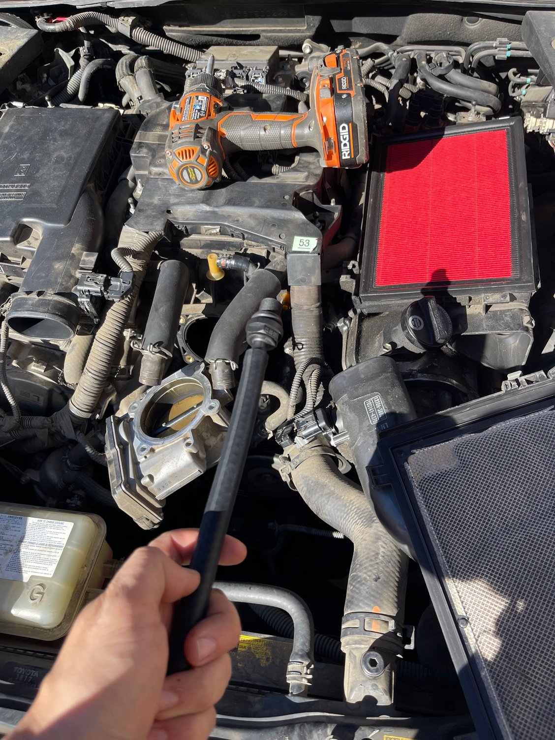

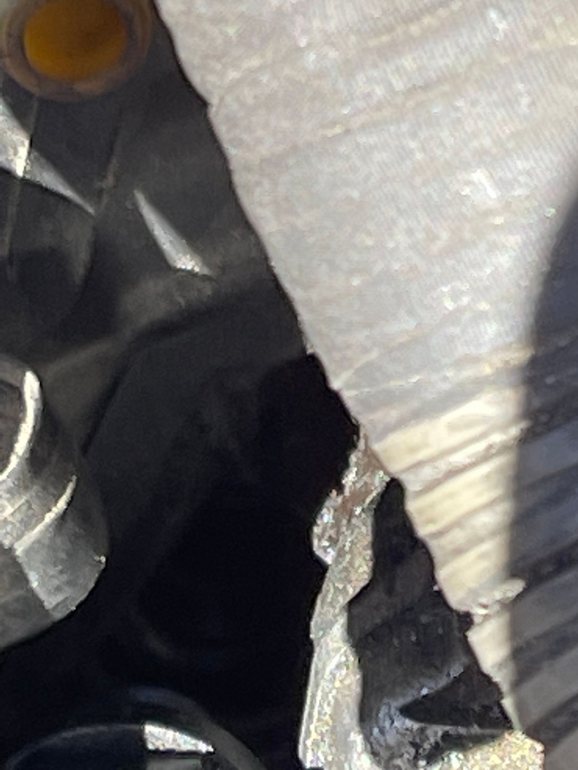

Yes you can get to pcv without taking intake manifold off. Going to get a fuel line to put new one in I will update

not really just remove the throttlebody whole thing took me about 35 minutes

35 minutes? I call BS. By the way you have a coolant leak at bottom of the throttle body.
Have been there and tried that. This method doesn't work on LS460 1UR-FSE engine, although it works on GX460 1UR-FS engine.

Congratulations! I Believe you. I'd like to retry it on my LS460. Would you please elaborate a bit more about how you did it? I mean, how you pulled out the old PCV valve and how you installed the new one? The details. How did you remove the sponge form surrounding the PCV valve/tube without damaging it?
