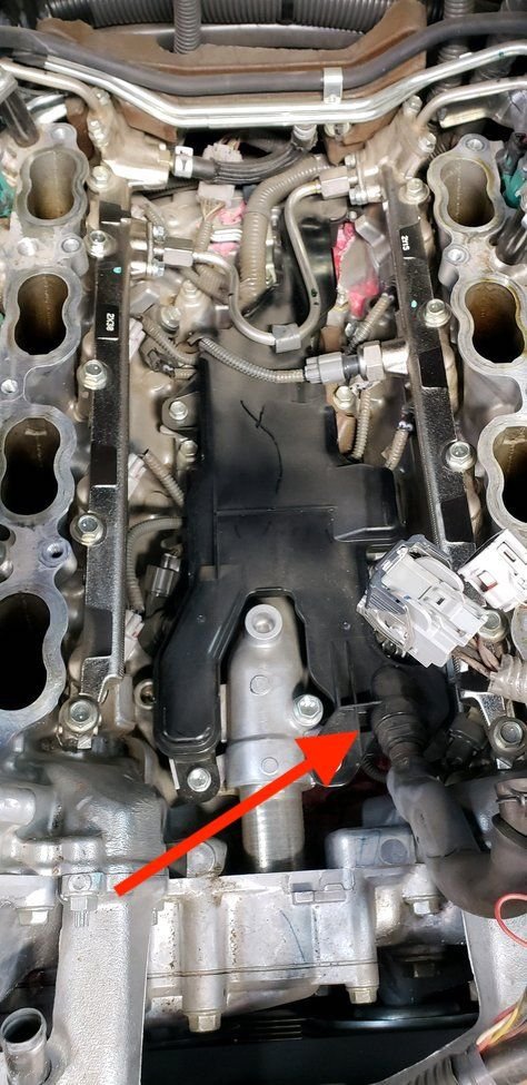

Hi, folks. I have been wanting to replace the PCV on my LS460 as preventative maintenance for quite a while, and I have bought all the necessary parts - the PCV, intake manifold gaskets, throttle body seal, etc. However, because Lexus shop manual says that the intake manifold and the main wiring harness on top of the engine must be removed as part of the PCV replacement procedure, I have been putting off my PCV replacement since my engine runs fine. Today, I read our fellow CL members on the GX460 forum sharing experience of replacing PCV valve on their GX460 engine without removing the intake manifold. Since GX460's engine (1UR-FE) is similar to our LS460 engine (1UR-FSE) in design and structure, and that both GX460 and LS460 engines use the same PCV (Part No. 12204-38010) and their PCV hoses are very similar (Part No. 12261-38080 for GX460 and 12261-38040 for LS460), my question is: Can we replace LS460 engine PCV without removing the engine intake manifold, as our fellow CL members in the GX460 forum did? GX460 CL members' PCV valve replacement reports are here: PCV Valve Location - Page 3 - ClubLexus - Lexus Forum Discussion (Postings 38 through 49). As an illustration, I am attaching two photos that show the PCV valve location in our LS460 engine (credit to "I Do Cars" and FatherTo1).
Location of LS460 PCV (credit to FatherTo1)
Location of LS460 PCV (credit to "I Do Cars"

Looks like it's possibly been done before. This was posted to a LS460 Facebook page. I'll reach out direct to the guy to verify:
