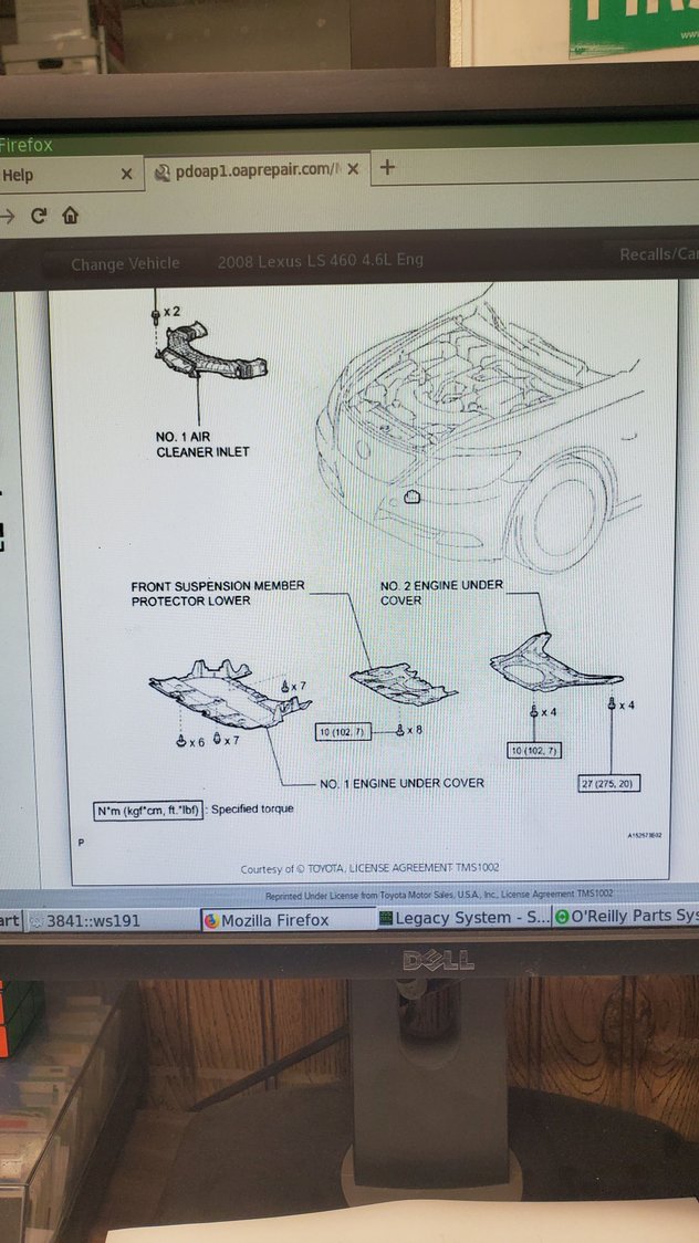

Originally Posted by robert1408
LS 460 PCV valve is under the intake manifold. Alldata shows 2.1 hours to change it. Some coolant has to be drained, the entire air filter and inlets are removed. Then the injector drivers and wiring harness are removed, followed by removing the intake manifold. The PCV valve is then accessible. It's not far from the oil filler, down in the valley.
so access is through the bottom not the top of the engine bay?
any pics of the location?
This should help .
File Type: pdf
File Type: pdf
File Type: pdf
File Type: pdf

Originally Posted by ALK
This should help .
Thanks for the help. I will put the pcv project on hold for now.

Default How to change the pcv if anyone is still wondering
Old Jul 9, 2019 | 10:59 AM
elejes's Avatar
elejes
Joined: Dec 2016
Posts: 104
Likes: 14
So I don't have to remove the fuel injectors? That's good, I guess I can give it a try. I'll order a intake seal while at it.
thanks!
