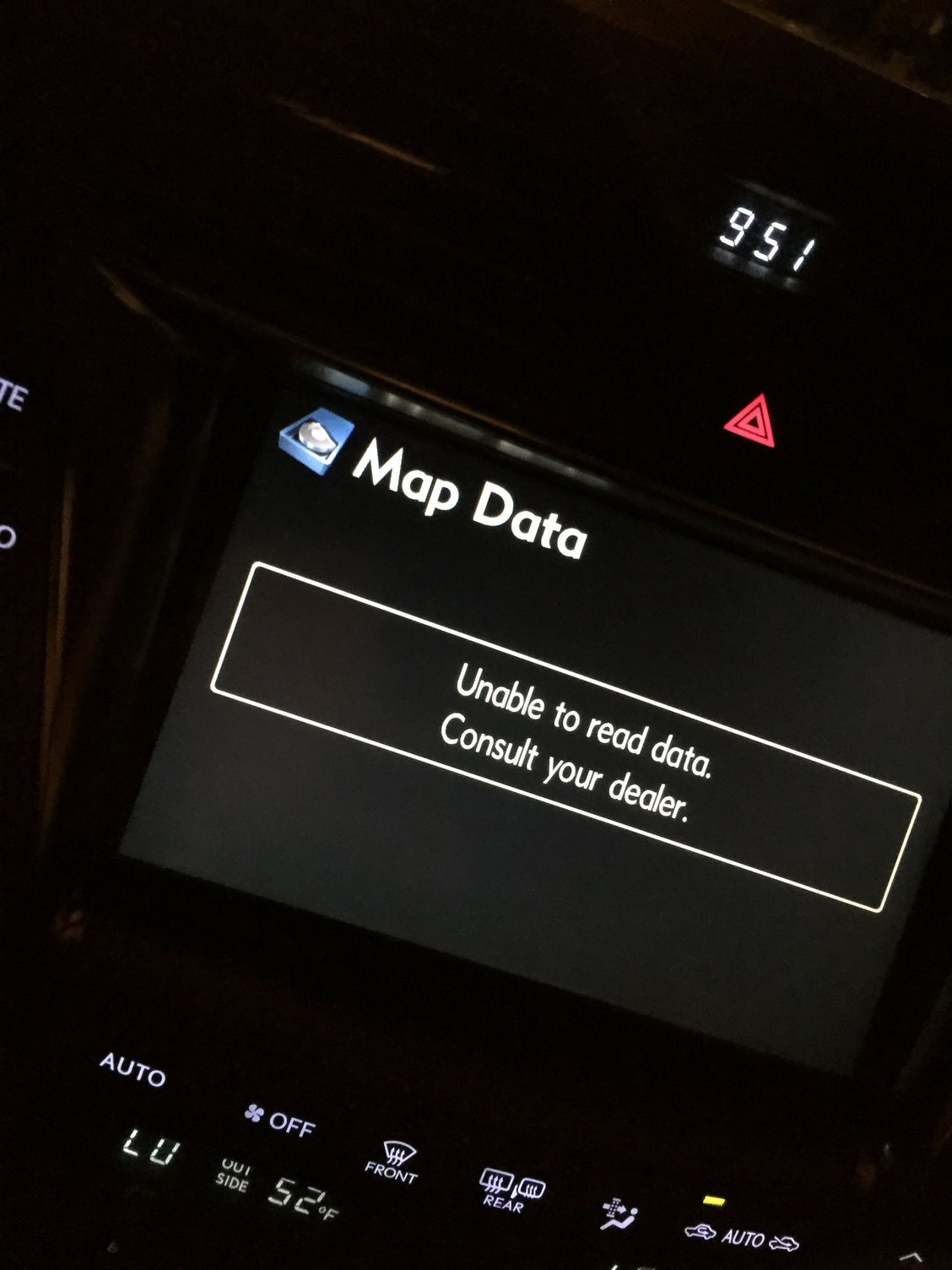

Hi guys, this is how my story goes...... so i just purchase this 07 LS460 96K miles less then 2 weeks ago, everything was working fine for the first few days then the navi screen keeps on popping up this message "Unable to read data, please consult dealer" I did many research on this forum and it seems like it's a bad HDD and I have also read it cost 15k to have it replace and such. I just bought the car and its out of factory warranty with the year and miles.... can anyone give me some advice on the best solution to have this fix? I see this unit on eBay from this totaled 2010 LS, http://www.ebay.com/itm/2010-LEXUS-LS460-HDD-NAVIGATION-SCREEN-WITH-AC-SCREEN-CONTROLS-86430-50430-/151500262092?hash=item23461e8acc&vxp=mtr will this be a cheaper route? but does it feed my 2007? I am just so frustrated right now and have no idea what i should do......

Try to find one for 07-09, I don't think this fits your car.
I would also try to take it to the dealer to do a NAV update, it is $99+ labor till end of the year. There is a slim chance that this can reinitialize the disk and fix the problem

Call United Radio in Syracuse NY. They can probably replace the HDD for a LOT less that the dealer replacing the entire unit. You could try the update suggested above but I think that's a long shot.
