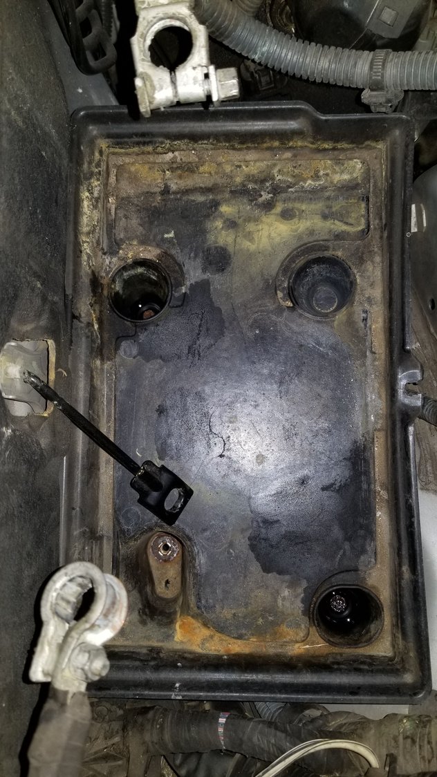

I am removing my battery tray now in preparation to complete spark plugs and fuel pump gaskets and have the same issue as william82 with 2 out of the 3 10mm bolt heads rusted, deformed and stuck (I was able to get 1 of the 3 out). I have sprayed penetrating oil and am letting them soak. When I get a chance I am going to run to Harbor Freight and pick up a bolt extractor socket to see if that does the trick. If not, I may have to drill them out. Anyone have any other ideas?

Bought the bolt extractor set from Harbor Freight and that did the trick. The bolts and battery tray are now out.

That drain tube never seems to work and the bolts just seize up. The one on the upper left i had to take a screw driver and and hammer it around the bolt to break the plastic and get tray out.
