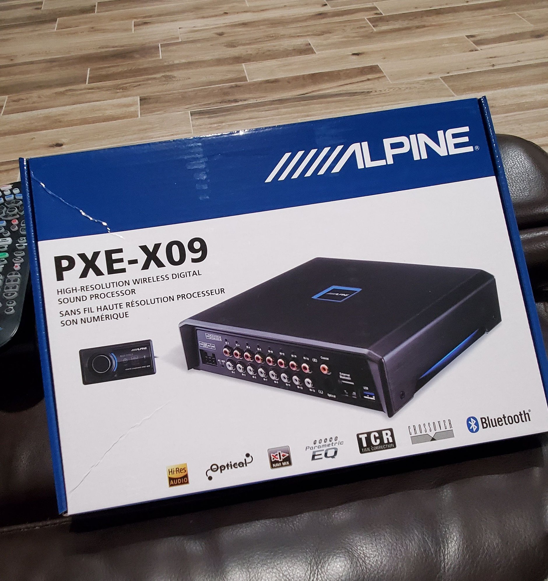

This just in Mark Levinston has FINALLY met its match!!! Meet the New Alpine PXE-X09!!! 16 (low or high level) input channels & 16 output channels!! More than enough to handle the ML audio processing w/o losing the Dolby Dts 7.3 built into the car.. (back story.. i currently have 3 Eqs, (2) 12 channel crossovers going to 2 Mmats Pro Audio Hifi 6150 6 channel amps & 1 Mmats Pro Audio 2000.5 )
Now I still need the amps.. but 5 components replaced by 1!!! PRICELESS!!!!
10 band Parametric or Graphic input Eq (per channel)
31 band Parametric or Graphic output Eq (per channel)
built in xover with time alignment
That can be tuned from a laptop or your smartphone!!!
