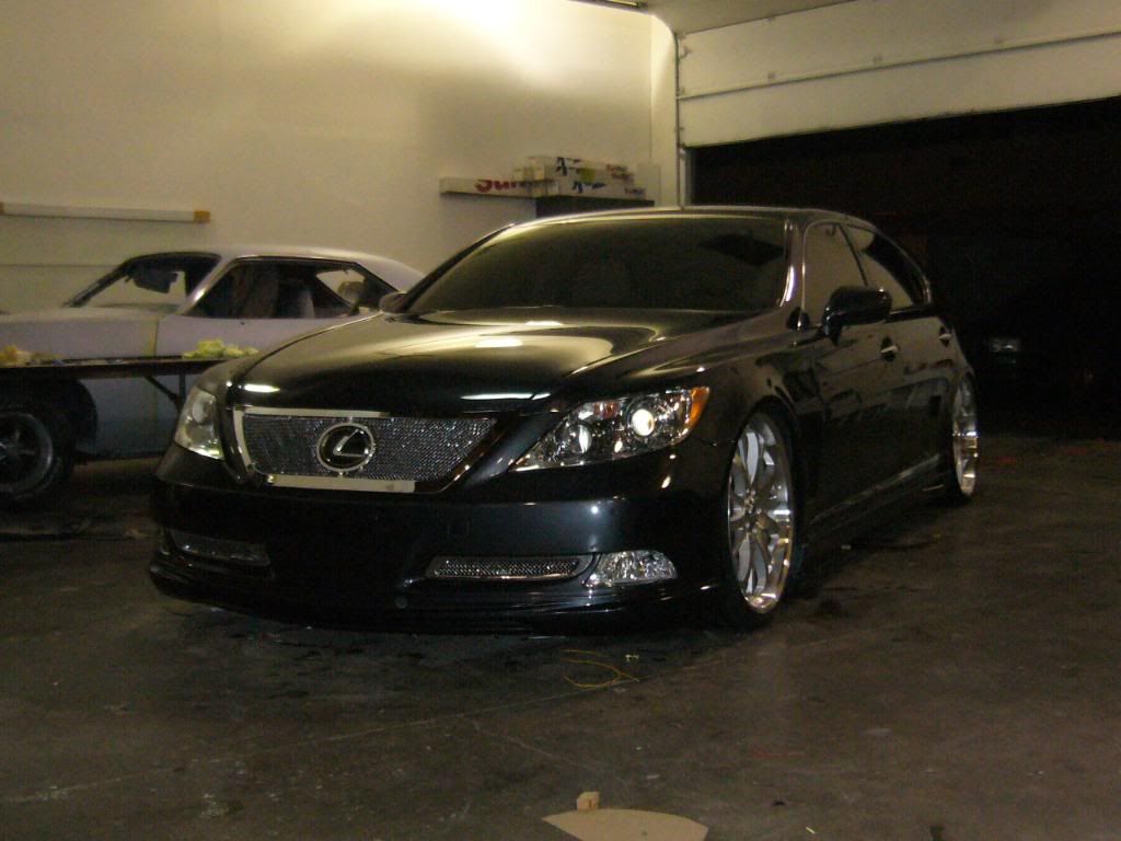

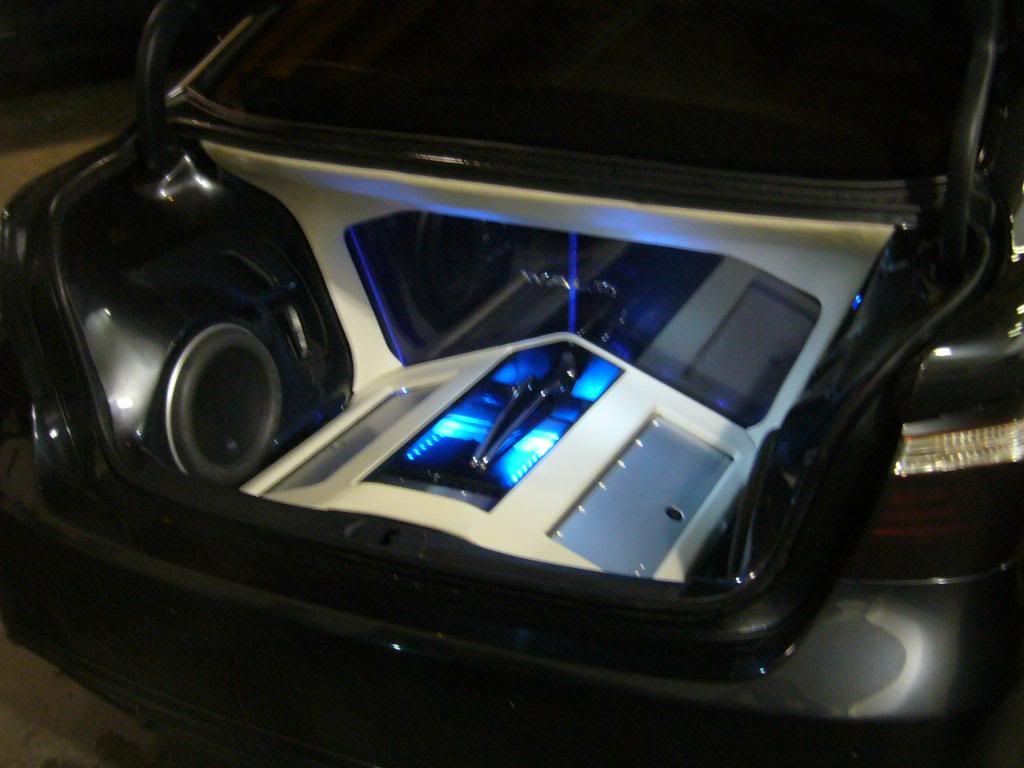

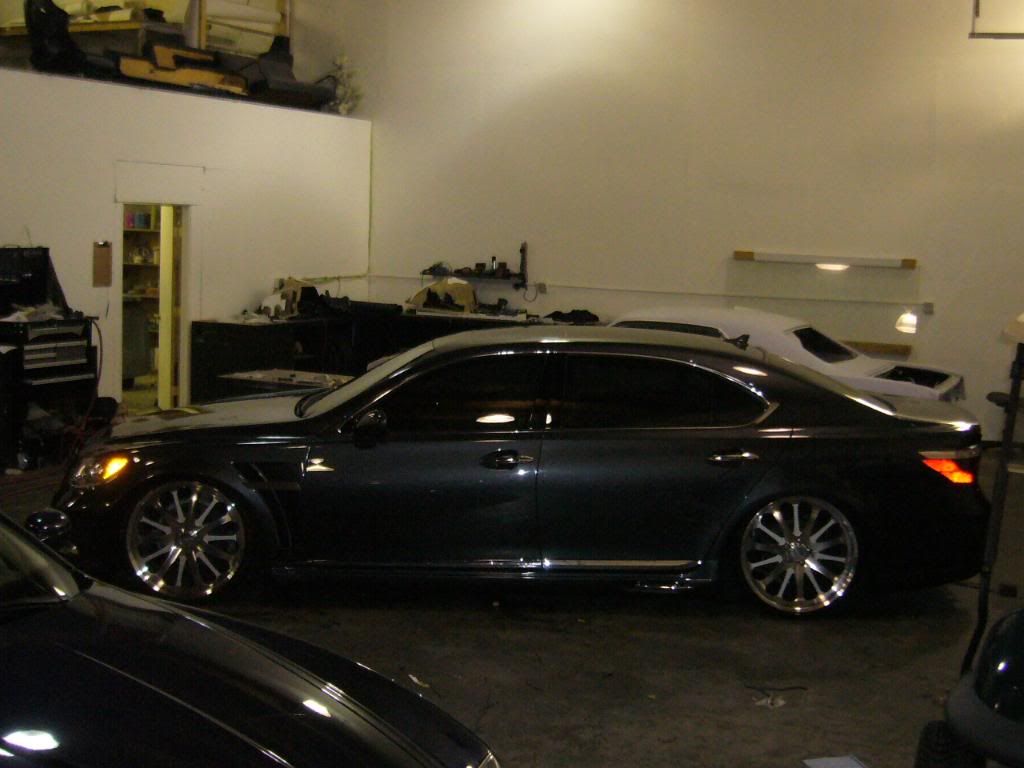

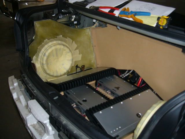

Here's some pics of the car. I have more install picks if you guys want to see them too
1st ur car looks awesome!!! 2nd if u ever wanna sell ur Wald wheels lemme know...
lastly i'm a bit stubborn when it comes to car audio (being a passion of mine) i'll keep going til i find a reproducible solution.. i've been in the car audio industry over 23yrs (damn i feel old saying that) competing in many spl an sq (IASCA & USAC) competitions.. not too mention most of my clients are certified bass-heads. i feel confident that the Ls wont be too difficult a vehicle to overcome..

also looking at your trunk pics... whats behind the plexi window? why didnt u vent the subs directly into the passenger compartment? with the subs that far back you will definitely encounter standing wave issues..
