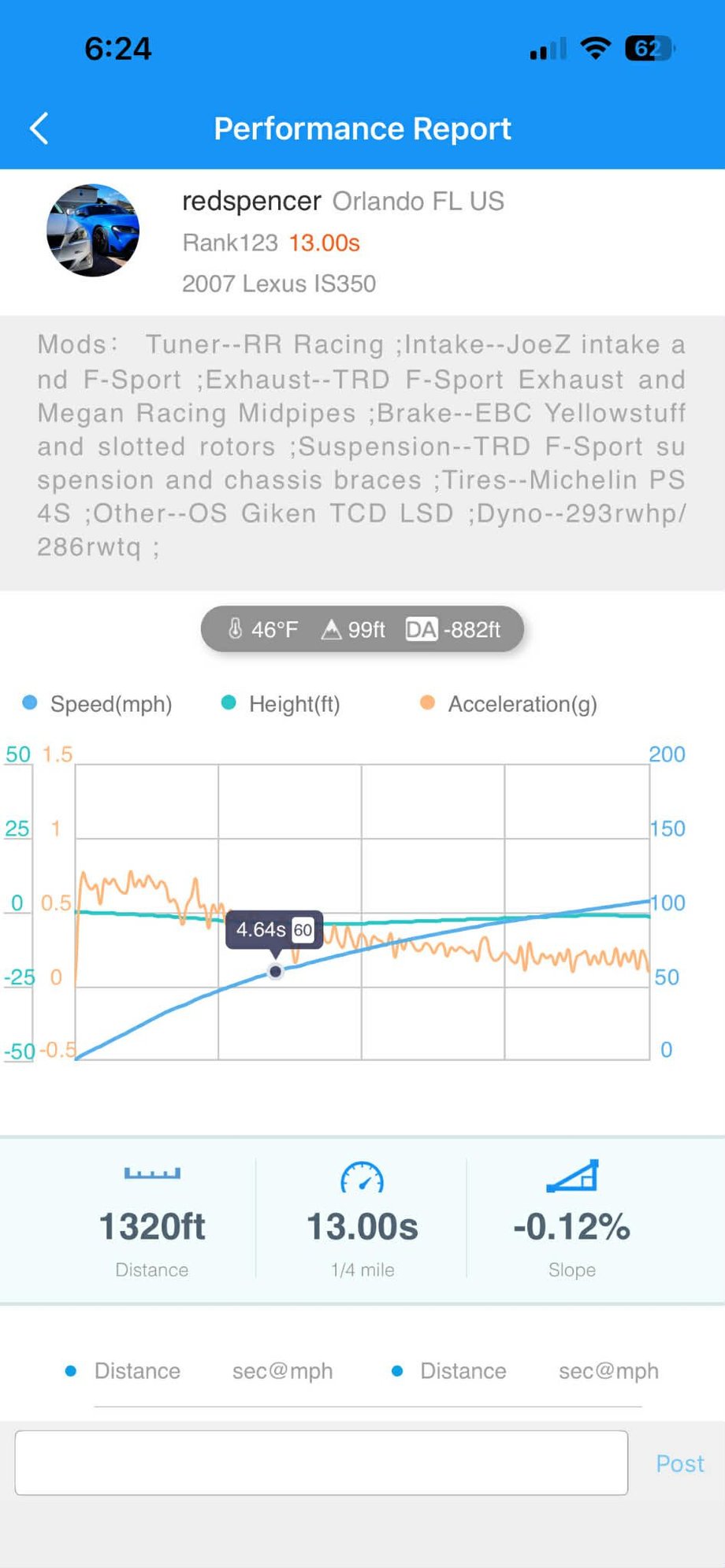

It's not new, because it isn't true. There are no truly "stock" 2IS350s running low 13s. They would have some modifications to do that, weight reduction, tune, or drag radial to help with launch.
The closest I've seen claiming stock is a 13.41. But tires could be upgraded.
That dragy slip is from RedSpencer, who had the world record for a very long time, and you left out the laundry list of modifications he had to run a 13.0...

That “Laundry list” of mods barely added 10-20 whp and 20-30 wheel torque from stock. That kind of increase typically accounts for maybe 0.1–0.3 seconds in the quarter mile, not an entirely different performance tier.Stock IS350s running low 13s is supported by lots of real data slips if you took a second to look.
13.459 @ 102.4 mph stock 2006 IS350 Premium.
https://www.dragtimes.com/Lexus-IS35...ce=chatgpt.com
Club lexus data showing the majority of stock IS350s in the 13.2–13.5 range. (13.2 discussed but not in poll)
https://www.clublexus.com/forums/is-...ce=chatgpt.com
One documented IS350 even posted 13.14 @ 105.8 mph stock.
https://dragtimes.com/2006-Lexus-IS3...ce=chatgpt.com

That laundry list included suspension, wheels, tires, engine, exhaust mods, and a $2000+ Limited slip differential, its quite a bit.
A 13.4 is not a low 13, it's a mid 13 at best.
Again, there are none running low 13s truly stock, in the last link you provided, he clearly list some mods, AND weight reduction, you just have to read it...
You don't need to argue, once your dragy comes in, you can show us what your brothers IS and your LS are running.
