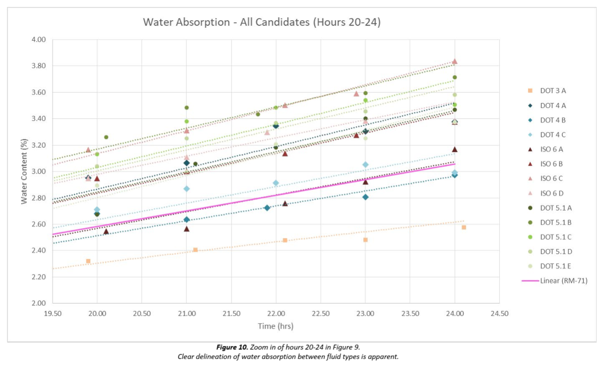

I think that in their marketing materials Bosch is comparing the DOT 3 and 4 to the minimum boiling points for DOT 5.1, that's the only way it would make sense. Dry DOT 3 has slightly a higher boiling point than wet DOT 5.1 but would drop below the minimum wet standards for 5.1 long before the much lower standards for wet DOT 3, which is what the data for Prestone Max DOT3 would be for. Where have you read DOT3 is allowed more moisture than DOT4? Everything I've ever seen has standards based only on boiling points. DOT has a longer lifespan because in almost all cases it absorbs moisture more slowly. From the link in previous post:
We can see that after 24 hours of humidification the Bosch DOT5.1 (5.1 E) has absorbed 30% more water than the DOT3 fluid. In the corrosion testing it is comparable in many metals but still exhibits higher rates of corrosion against some metals

Your own provided charts prove that it not only can absorb more water when exposed to a worst case scenario but that even then it still provides comparable protection as DOT3. 30% more ability to absorb water and still hit spec seems substantial to me...

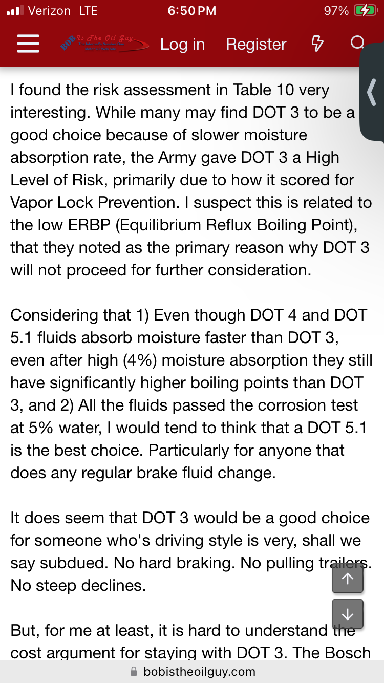

I encourage everyone to read the thread from BITOG as it confirms the superiority of Bosch 5.1 over the other options. I'll provide a screenshot of the relevant section however
https://bobistheoilguy.com/forums/threads/brake-fluid-military-testing-dot-3-v-dot-4-vs-dot-5-1.354498/

Brakes are a sealed system, moisture intrusion is not a given when the brakes are pressed depending on seal conditions. Solid butyl rubber, polypropylene, and even viton will let water vapor pass through over time, so much of it is probably a gradual process. 5.1 does not have 30% more ability to absorb water, it has 30% more propensity to absorb water. All wet specs are based on 3.7% water content. All the Dot 4 and 5.1 tested reached that 3.7 saturation point more quickly than the DOT 3. Moisture causes corrosion, which is why almost all Dot 4 & 5.1 exhibited greater propensity for corrosion against almost all metals tested. They make up for this by having a higher boiling point throughout the curve, which is why I said if someone is more concerned about system longevity without regular brake fluid changes than they are about boiling fluid then DOT3 would be a better option for them, and vice versa. OP said he "drives like an old lady" and is worried about actuator lifespan, so he likely falls in the first category, as do I.

Curious as to what brake brands you bedded that had you overheat them as part of bedding, I've yet to encounter a brand that advocates intentionally overheating till pad fade. Link them if you would, most pads and brands don't even explicitly outline instructions on bedding and brands that do never result in overheating.
Brakes are not a sealed system, the res cap is not airtight at all. Almost all moisture enters though this area, you expose the same amount of water to the fluids and they will both absorb it....one simply does so without as severe of a penalty.
Read what I wrote again, you are failing to understand. Also read the linked threads. Higher spec fluid, and ESI6 in particular lasts longer and has less corrosion risk.
