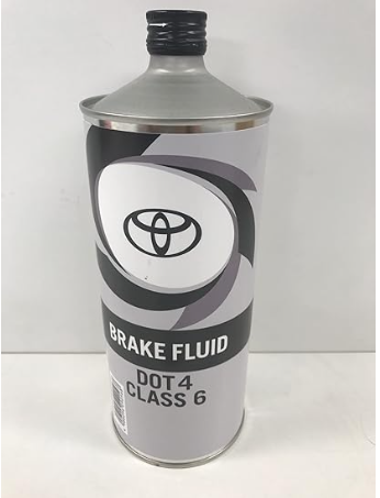

Originally Posted by jbtvt
DOT 4 absorbs water more readily than DOT 3 and since water is likely the root of the module failures it would not be a good idea to use. I'm pretty hard on my cars, although not tracking them, and DOT3 has always been fine.
You must have been thinking of DOT 4 class 4 which is the thickest brake fluid out there and no longer meets the requirements for most vehicles built after 2010.
DOT 4 class 7 or ISO 4925 class 7 has the highest boiling point, the same as DOT 5.1, and it has the same low viscosity as class 6.
Kevin can explain this better via the attached article.
Here
Here
Interesting article, that's the first I've heard of class 6. All DOT 3 fluids I'm aware of are supposed to outlast Dot 4 and 5.1 fluids. Just checked now to make sure this hadn't changed and seems to hold, for example entry level Prestone Dot 3 and 4 are both "rated" for 50k miles lifespan under normal conditions, but their DOT 3 Max is rated for 25% more lifespan than their DOT 4 Max max https://www.prestone.com/product/pre...t-brake-fluid/
https://www.prestone.com/product/pre...4-brake-fluid/
Advics says the same
https://www.advicsaftermarket.com/te...ot-3-vs-dot-4/
"DOT 3 brake fluid will normally absorb less water from the air in the braking system than DOT 4, over time. This means that DOT 3 brake fluid will have to be changed less frequently than DOT 4.
DOT 4 brake fluid has higher wet/dry boiling points than DOT 3, making it a better choice for higher temperature braking applications, like in high-performance vehicles."
It's strange to me that the Bosch fluid marketing states it lasts "100% longer than DOT 3, 50% longer than DOT 4, and 10% longer than DOT 5.1" since that's the only time I've seen it claimed that DOT 3 has a shorter lifespan than the others. Their SDS doesn't give the CAS# of the primary component. I did find this discussion when trying to see how it performed against corrosion https://bobistheoilguy.com/forums/th...ot-5-1.354498/ lots of good data there and I think I'll give that DOT 3 that had the best corrosion results and cold weather viscosity a shot sometime in the future, AC Delco 10-4110
Anecdotally, I experienced a higher rate of caliper failure over the years when I used DOT 4 fluid than I did after switching back to DOT 3, although this was just basic parts store stuff, nothing special. If someone changes their fluid regularly then hygroscopicity and corrosion resistance wouldn't matter so much but life sometimes gets in the way of even the best intentions.
