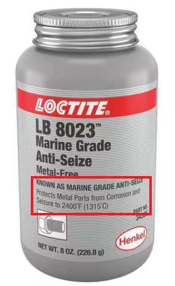

Originally Posted by SaltwaterFishing
I'm not sure I want to put any type of lubricant on the rotor or anything that serves the purpose of stopping....
I do respect your opinion. A little research might convince you of the benefits of a thin layer of anti seize on both the hub and wheel sides. But even if you don't feel like doing so, the benefits are small for a normal driving situation.
Even if you did put this on the rotor, wouldn't the heat dissipate the anti-seize?

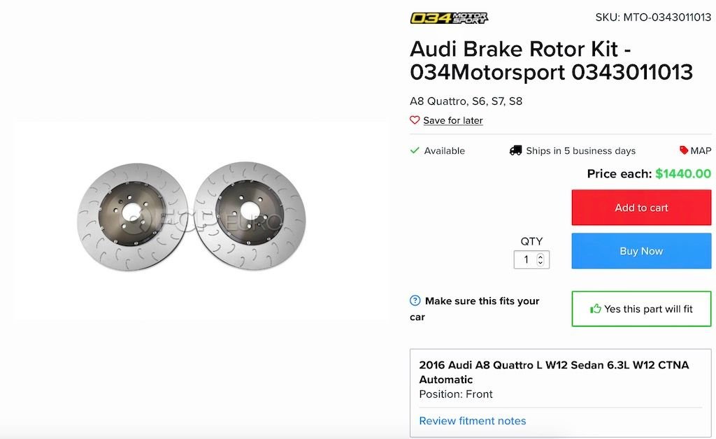

Well yeah, the F sport has 380mm brakes. Same as mid level brakes on an A8/7/S-class, the stock car with a freaking 5200lb AWD 460 is using 334mm tiny little brakes that the Germans don't put in a 4050lb car.
So, can't compare different models but it's perfectly fine to compare brands in the same thread...you guys are funny.

Well yeah, the F sport has 380mm brakes. Same as mid level brakes on an A8/7/S-class.
Are you saying these front rotors from FCP are mid level ?
I'm saying those are below mid level rotors. These are mid level rotors.
Stock S8/W12 brakes are 400mm floaters, optional are CCBs. You have 380mm below that for all V8 cars, then 365s on some euro specs and 330mm for V6 and hybrid cars.
So yeah, 380mm is the mid level brakes. Lexus extreme top end stops there.
https://www.tritonmotorsportsusa.com...c-brake-rotors
If those are mid level than anything the LS460 uses is trash tier pot metal drum brakes lol!
