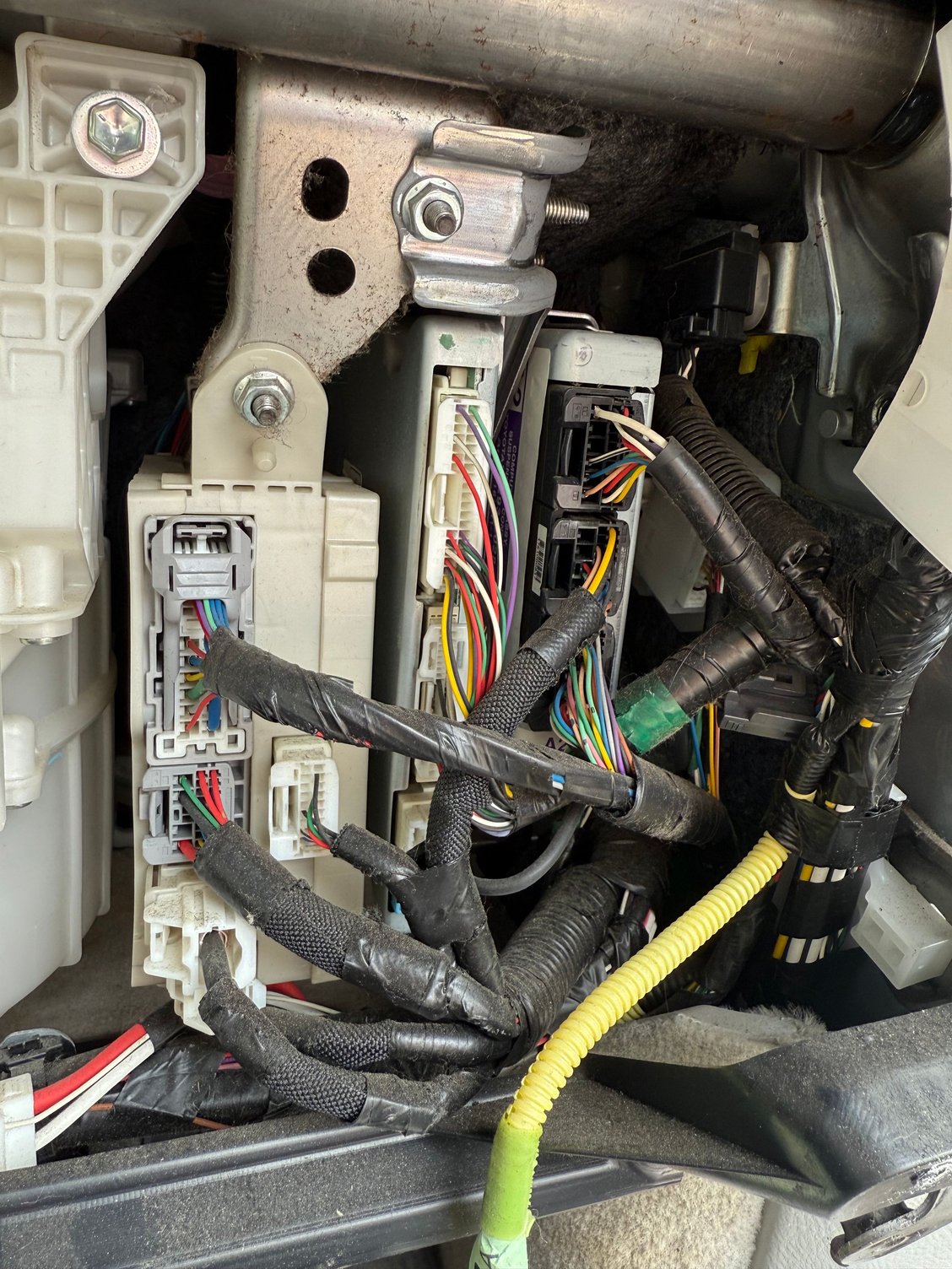

Hi all,
I recently purchased (yesterday) a 2009 AWD LWB (LHD). The PCS Light is on due to the A/S being swapped for traditional coil/struts (Strutmaster Brand). I had the vehicle inspected and everything electronic about the A/S is intact, so the tech and I summarized that likely the emulator was dead, or none was installed in the first place.
I confirmed that no Strutmasters “Lights Off” module is to be found behind the glovebox and nothing is spliced or plugged into the suspension ECU.
Strutmaster sells the emulator for $450 USD. I’m in Calgary, AB, Canada, so $450 is like selling my left arm! Eventually I will convert back to A/S just to try both sides of the coin and have an educated opinion on which I like better.
Does anyone have a recommendation or aware of a less expensive module/emulator that performs the same idea of tricking the suspension ECU into thinking the system is operating normal? This way I can enjoy the radar cruise and other options that are currently being held back.
Pic to prove I actually looked!
Any help is appreciated, and I apologize if this has been covered; I swear I did some searching before I posted!

Just disconnect the air suspension ECU. If you have AFS, you will have to disconnect its ECU as well, or set left front height sensor to the medium position.
I appreciate the reply. I do have AFS; I’d love to keep it going (as I haven’t even had the opportunity to try it out yet).
I’d like a confirmation from you that the A/S ECU is the one on the far right? I disconnect all harness’ (X3 connectors)?
I’ll google how to do the height sensor adjustment. Therefore to confirm, disconnect all 3 connectors and move the height sensor to medium on the front drivers side?
Thanks again.

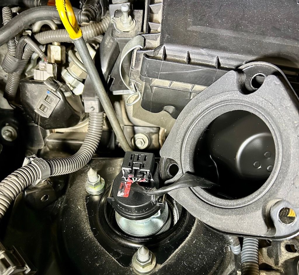

My car is awd also and I've lowered it about 2 inches all around using the mechanical height adjusters and it didn't affect the headlights in any way or turn on any lights, they may have a single sensor for height on a rwd but I've never owned one of those so I couldn't say for sure. https://www.clublexus.com/how-tos/a/...ring%20springs.
If the AVS actuators on the top of each shock aren't left connected to the electrical connector harness like in the picture from my car you will get some codes and lights if left unplugged so yes if you could check or have someone retrieve the codes it would help. I have a hard time believing the pre crash system light is on with no associated codes like that dealer told you.
